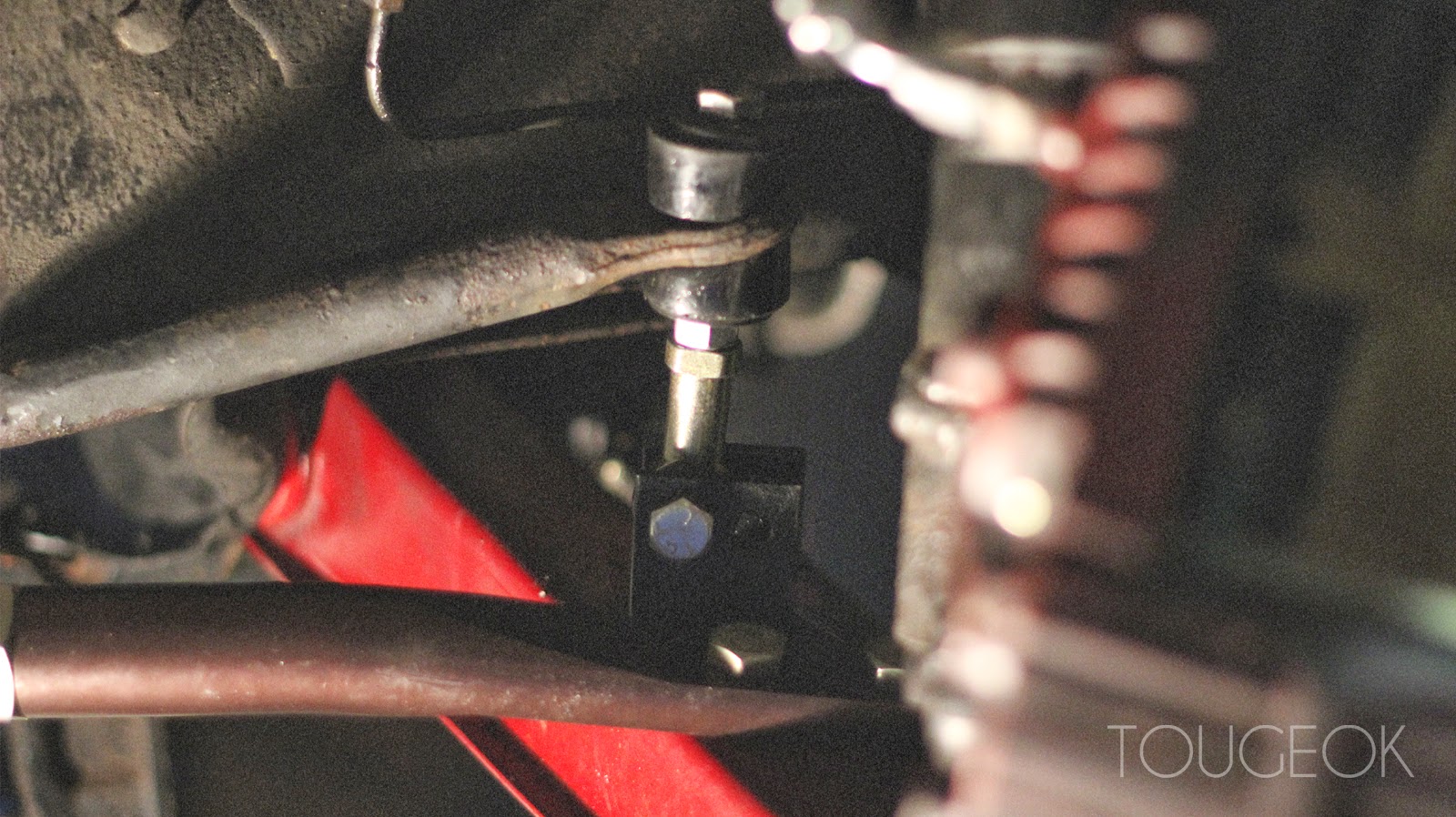

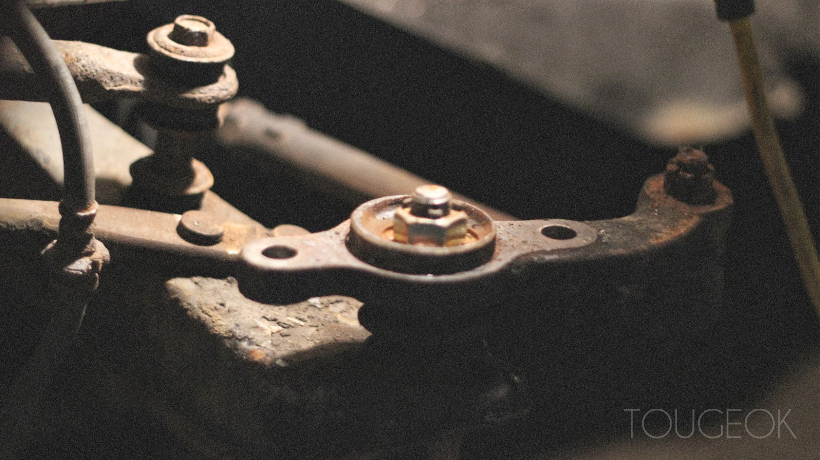

Its no secret Z31s have astronomically bad steering angle, So I got my hands on some modded knuckles

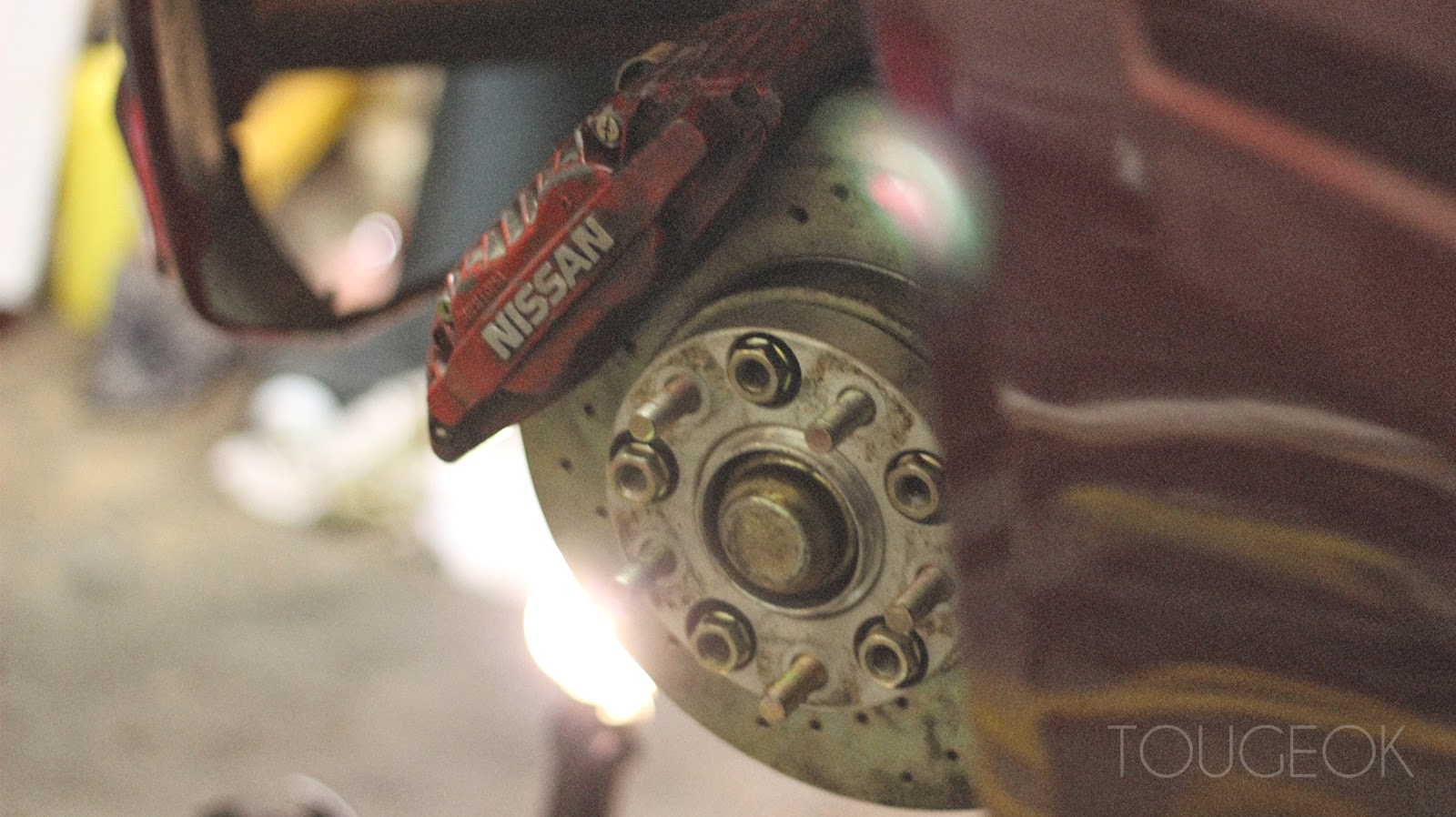

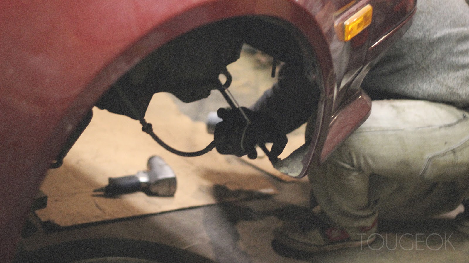

I installed OEM tie rod ends, ball joints, wheel bearings, Stance 9k/7k coilovers, Z store quick links, Stance tension rods, 87 z31 turbo front hubs, poly rack and LCA bushings, Modded knuckles, welded the stock diff and Z32 front brakes.
(I originally didn't want big brakes because I wanted to run 15in wheels, but the brakes just happen, too good of a deal to pass up)

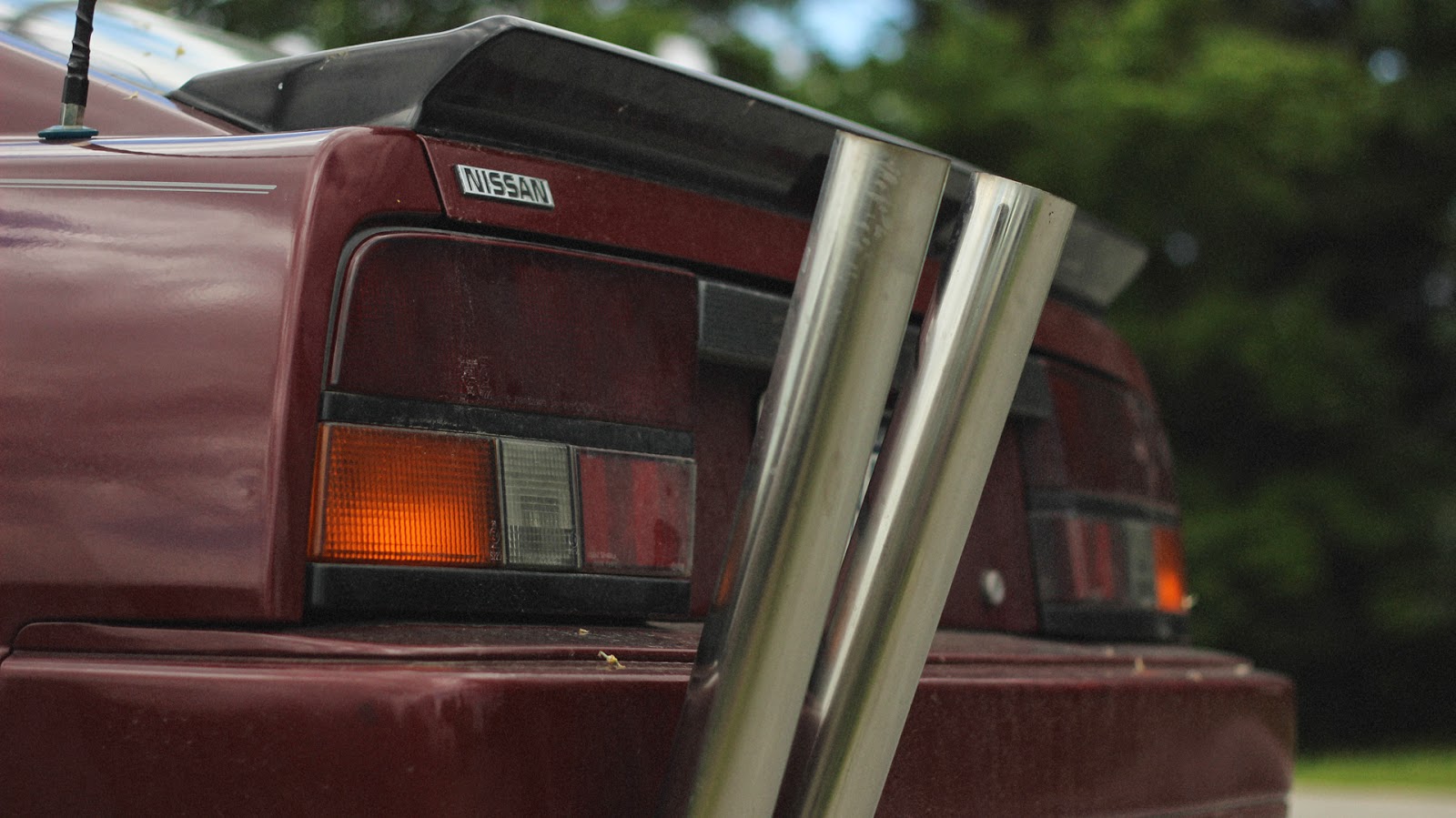

With some downtime I installed a 3in straight pipe, got the car aligned and bought some wheels.

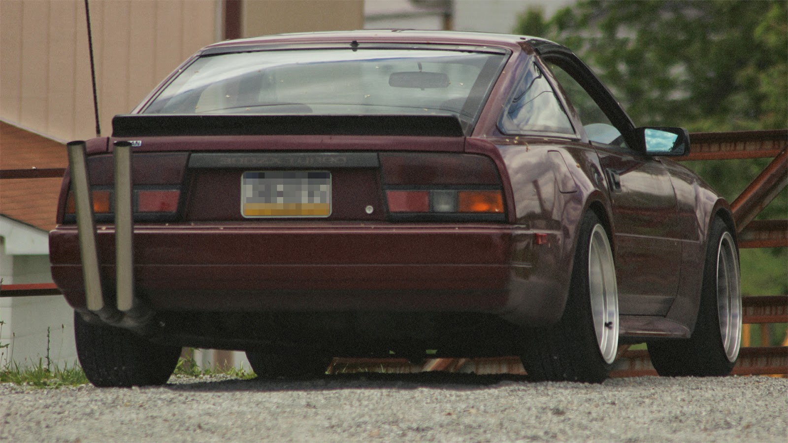

OG san17, 17x10 +15 with a 25mm spacer, square.
I wasn't happy with the wheel gap, But I waited till the next drift event before lowering it. (didn't want to throw away my alignment without at least trying it.)

The car feels good, but my plans are to extended the Front LCAs and install Stance tie rods (inner and outer) with spacers for more angle, and eventually get the car caged. I'll Keep the updates coming.

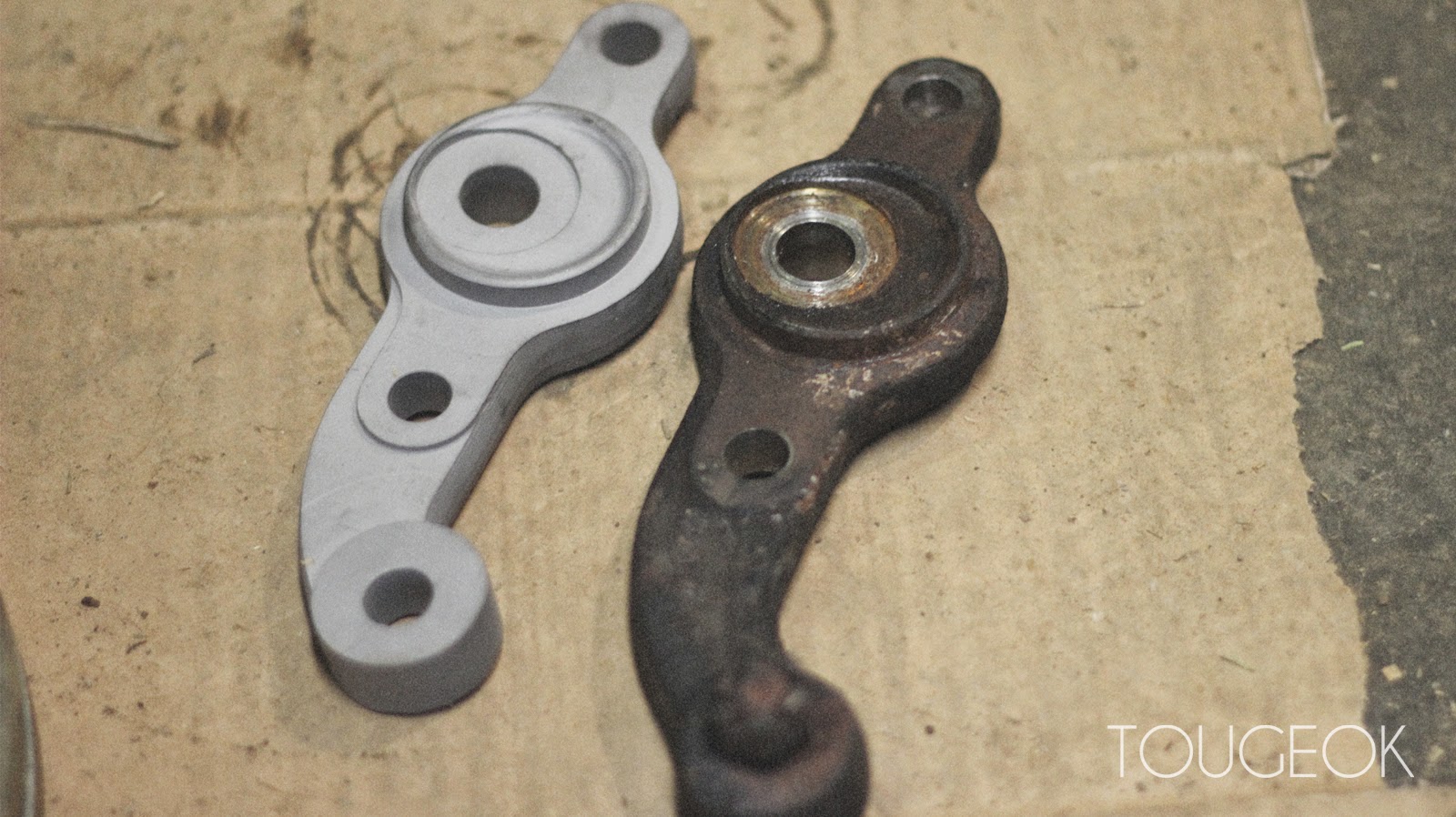

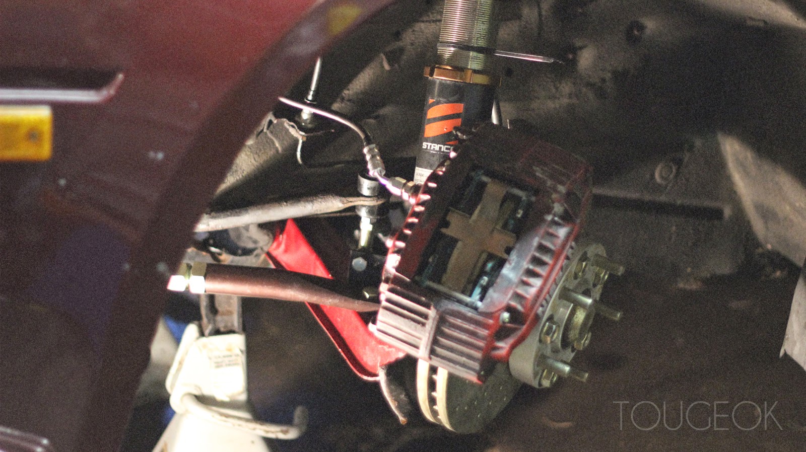

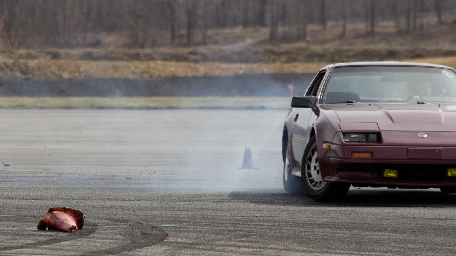

So April 2014 rolled around and it was the 1st drift event of the season!
I was soooo worried about the engine because of the initial oil problems, but the 160,000 mile VG sung all day long. With just a rad cap failure the car was mint, amber fogs and all, lol. Happy with the car I couldn't wait to get more seat time.

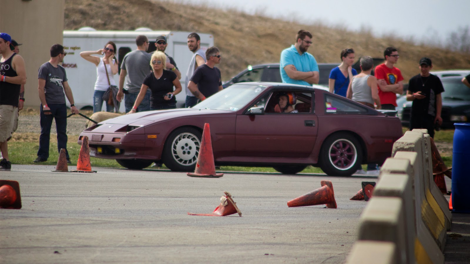

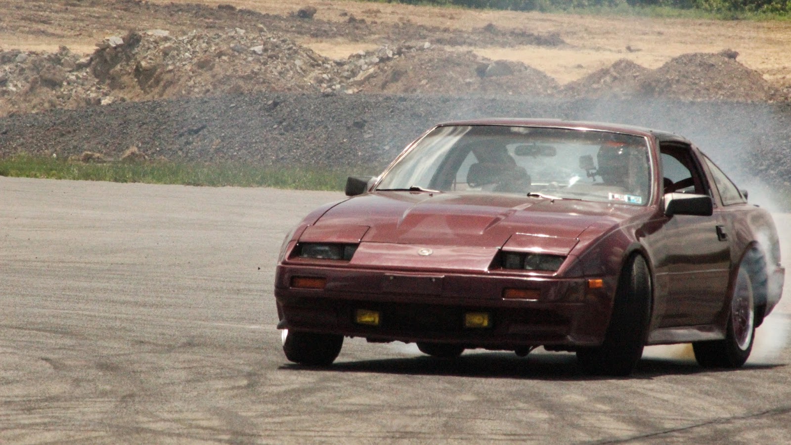

And just this past weekend I slid the car at the June event.
