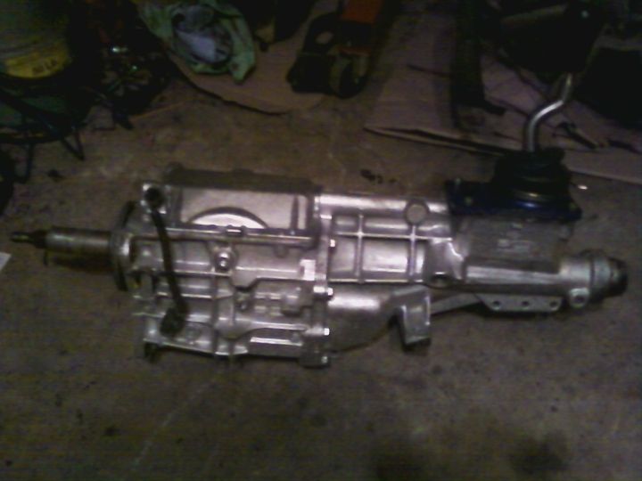

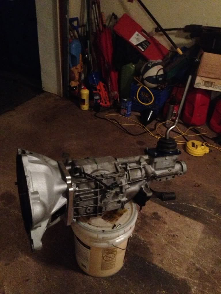

Found another transmission, this time I made sure it was the right one, in good condition. Here it is with the bellhousing adapter.

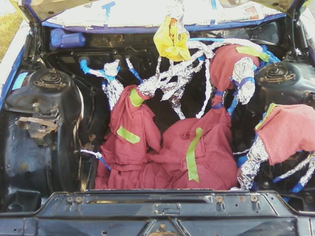

While the motor and transmission were out I decided the engine bay needed to be taken care of while I was earning money for parts. Here's how it started.

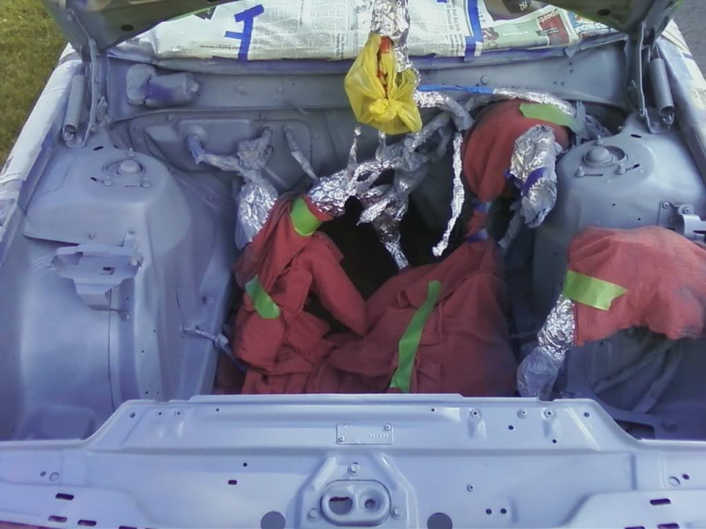

Primed.

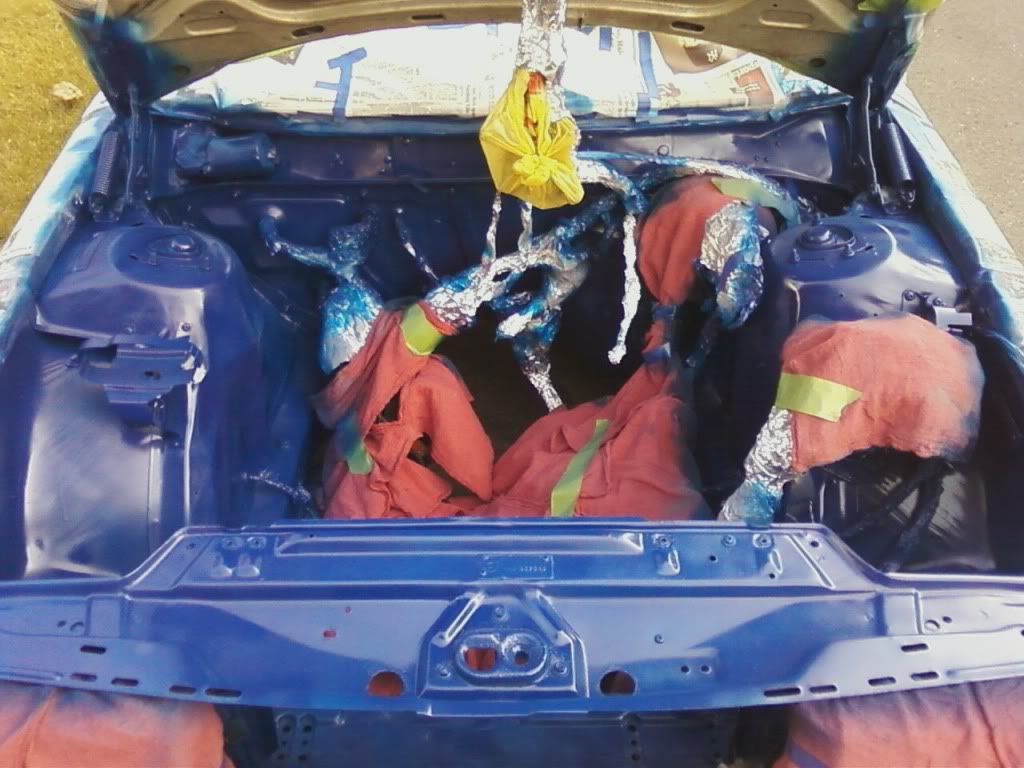

Went blue. Looked like shit.

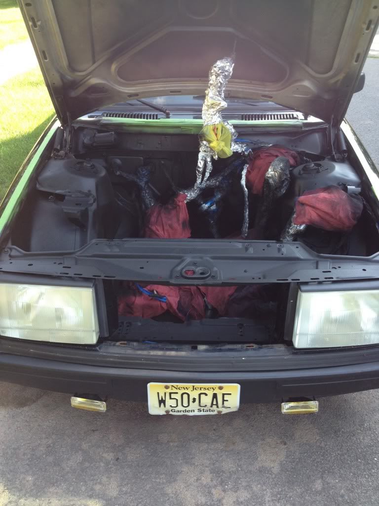

Redid it with Rustoleum Bed Liner. I'm very happy with how it looks. I also did the entire bottom of the hood after this picture.

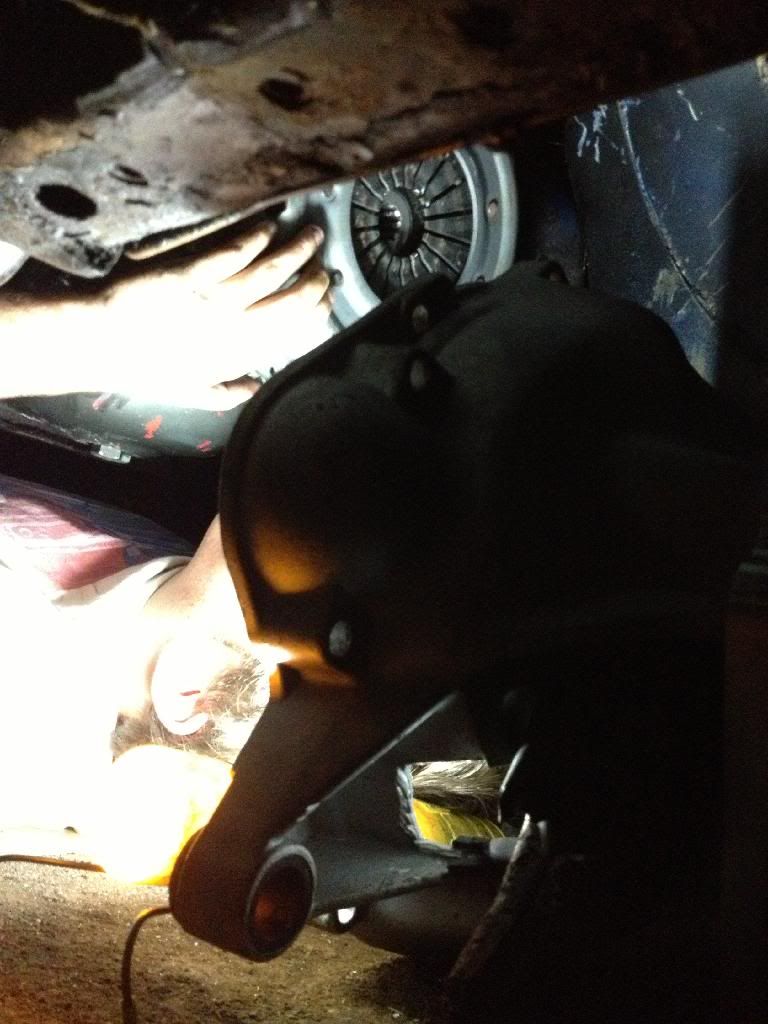

The engine and transmission went back in, and it was all rewired. It wouldn't crank, starter wires were mixed up. Fixed that. Wouldn't spark. Sanded all grounds and rechecked all wiring. Still no spark. Sanded coil connection, got spark. Would crank, spark, had fuel but wouldn't start. These cars are timed off the flywheel. If you put it on wrong, it retards the timing a ridiculous amount. Turns out, it was put on wrong. So the transmission had to come back out. Fun stuff.

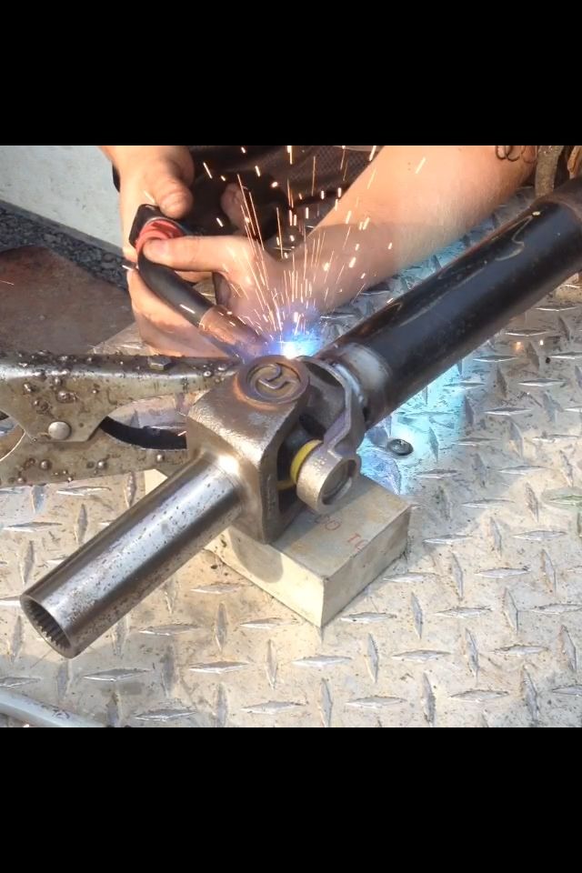

So now it ran and the clutch worked and all was dandy. Just needed to modify the driveshaft to work with the T5 output shaft. Simple enough, followed a guide online and my brother and I tackled it in a couple hours.
Primed.
