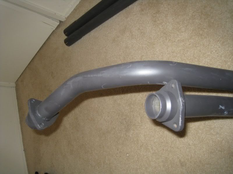

I found the exhaust fitted to the car is an aftermarket set-up. It started to sound a bit strange and when i rode with the mechanic he agreed and thought it was probably the center muffler.
I inspected further and the badly repaired rear manifold seemed to have cracked again
AND the front manifold was not even bolted to the exhaust @ the flange!! I don't know who installed this exhaust but they sucked. Talk about an exhaust leak.
I ordered a whole new exhaust from the classic center and sourced a replacement rear manifold from Sun Valley dismantlers
Car is down at the mechanics now getting sorted out
Looking forward to hearing the car the way it is supposed to sound.
Exhaust fitted to the car currently
Badly repaired rear manifold which I think has a recent crack in it
Front manifold NOT bolted to exhaust!
New Exhaust from Classic center
New Mounting bits and manifold gasket
Finally on
Finally on
