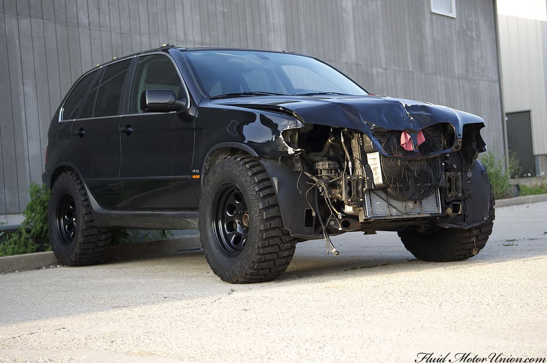

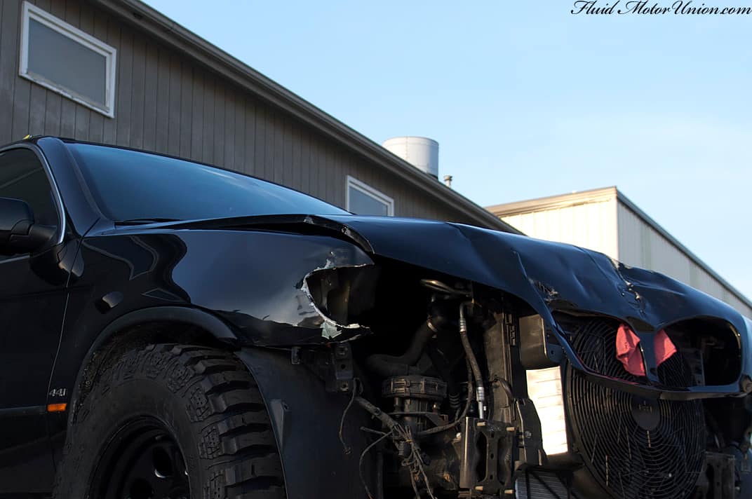

    Project X, before we gave it that name, wasn’t even our car to begin with. Rather, it was a wrecked X5 brought in by a customer with the goal of fixing it and giving it back to the owner. Well, as time went on, the customer gave us the car, but disappeared shortly thereafter. After plenty of time has passed, and after plenty of attempts to get a hold of the owner, we were left with one choice – put a mechanic’s lien on it. So we did, and that’s how we ended up owning this Bavarian beast.
    Ideas had been swirling in our head ever since we took possession of the car. We knew one thing from the outset – it wasn’t going to stay stock. But the second question was a bit trickier – what were we going to do with it? After plenty of thought had been given to the subject, we settled on creating a vehicle that oozed the aesthetic of urban assault, with the typical Fluid goal of launching fireballs. So we started doing some drawings and got to work.

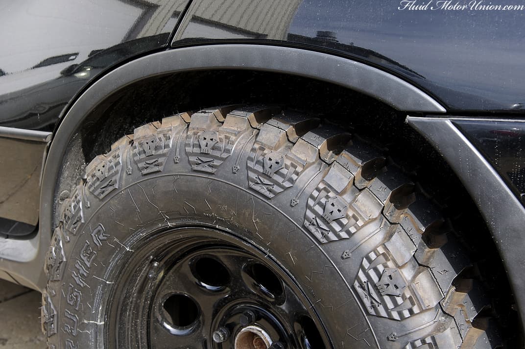

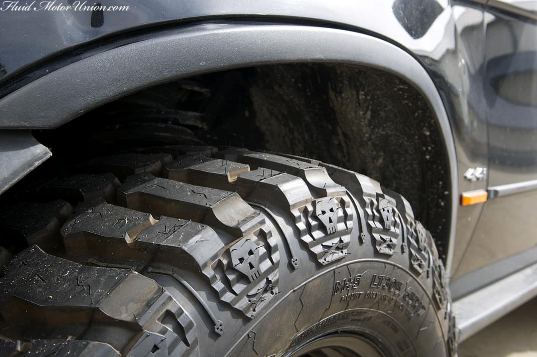

    The wheels and tires were the first addition that took almost no time to settle on. In searching for the most aggressive SUV setup we could, we settled on Cragar’s steel wheels for that heavy-duty steelie look, and a set of Dick Cepek tires. These aren’t your normal tires – they are covered in skulls and bones, which doesn’t give off a very happy-go-lucky, take-your-kids-to-soccer aesthetic that’s typical of a normal X5.

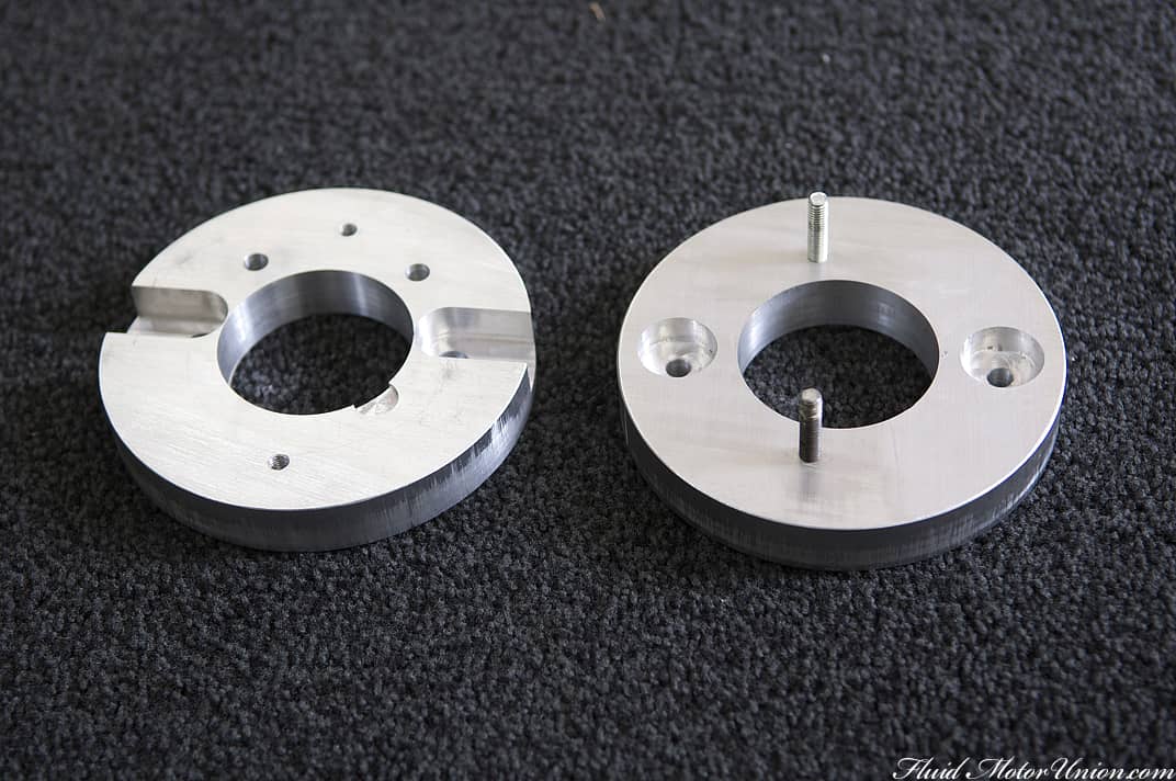

    From there, we needed to set the X5 up such that the tire clearance wasn’t a problem. Instead of trying to find a kit on the internet, we made our own custom lift kit for the X5’s OE suspension setup. Featuring a billet aluminum set of spacers, it lifted up the X5 between 1 and 2 inches, providing the clearance we needed.

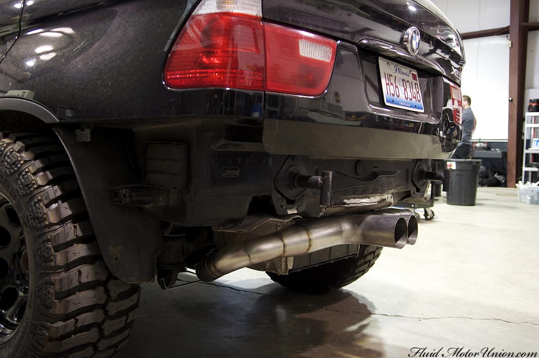

    Finally, we made the exhaust for it. As with all our other custom setups, this featured nothing but 304 stainless steel and TIG welding. The setup is relatively large, with the midsection running 3” pipes up to the rear, where we expand to 4” at the tips. We went with a different routing system, as well, choosing to exit the pipes through the rear tow hook panel on the rear bumper. Sometimes it’s nice being able to showcase your craftsmanship front and center. Plus, the two tips directly next to one another could provide for much better fireballing.

                        If you remember, we received this X5 as a heap of metal waiting to be reborn into something that isn’t waiting for a junkyard. Given its rough-and-tumble looks upon arriving at our shop, we needed a few new body parts to make the car whole again. Just about everything on the front needed replacing, so we sought out some new headlights and kidney grilles, along with a hood and whatever else needed replacing from the front end.

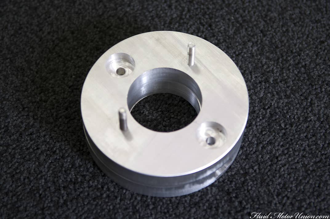

                        We also made mention of the wheels and tires in the last post. While the lift kit helped eliminate most issues with the wheels/tires fitting in the wheel wheels, it didn’t solve all of them. The last issues can be remedied with a set of spacers. So we made some. We weren’t going for extreme poke, so they’re not 55 mm or anything, just enough to get the wheels/tires to play nicely with the wheel wells.

                              you had me at the first picture. looking forward to the rest of the build.
