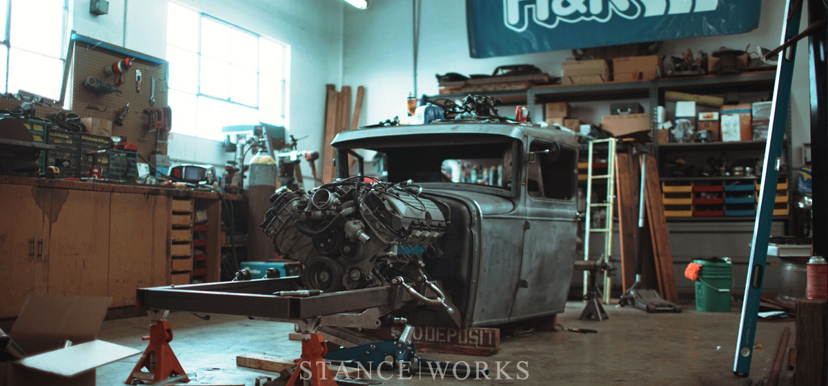

It’s been a hot minute since I photographed my progress on the truck. I’ve taken to YouTube to document my progress, which has been a new, fun, and rewarding addition to the content I get to make, but it felt like a great time to slow my roll, grab the camera, and share some good old-fashioned photos of I’ve been up to.
The biggest outstanding project on the truck is undoubtedly building and conquering the custom independent front suspension. Front the get-go, I knew I wanted to build something on my own, and having experienced the dead axle setup from my previous Model A, an independent suspension system was an obvious choice. All of the calculations and drawings are finished, so I’ve moved to physically building the components. The cross-members are complete, and the upper A arms are finished. Up next are the spindles and the lower control arms. Once together, it’ll be the biggest milestone yet. Following that, my custom coilovers will arrive from H&R, and as a complete package, this truck is sure to ride better and out-handle its predecessor, through and through.
