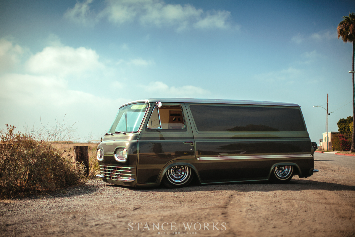

Working with many of the same design cues as, say, a loaf of bread, Coby set out to plant the van firmly on the ground: the first objective on the growing list of custom touches for the lump of steel. KA Custom in Huntingon Beach, CA received the van and the orders, and within no time, a custom chassis was built. Mustang II front suspension components were used for their simplicity and to help eliminate the bump steer prevalent in slammed beam-axle front ends, and mated just behind the front clip is a tried and true Chevy 350 small block. Unfazed by the criticisms of using a Chevy motor underneath Ford steel, Coby touts its reliability, power, and of course, its cost-effective nature as the reasoning behind it… although, “cost effective” was likely the last reason for any other part of the Van Go build.
Perhaps the toughest part of the chassis build was the steering system, which required a custom chain-driven steering gearbox to both fit and work properly in the limited cab space. While most vehicles have an engine bay to house bulky components, the Econoline’s flat face and forward seating position meant that Kevin and Steve from KA Custom had their work cut out for them, hiding everything to yield an uninterrupted finished product.
The wheel wells were raised too, further cutting into the driver’s cabin space. Lowering the truck by such a significant amount meant the wheels and suspension components needed a substantial increase and room. The rear end is a similar story; while the solid rear axle makes things a bit easier to build, the rear of the cabin is consumed by the space required for all of the suspension components, as well as the fuel cell.

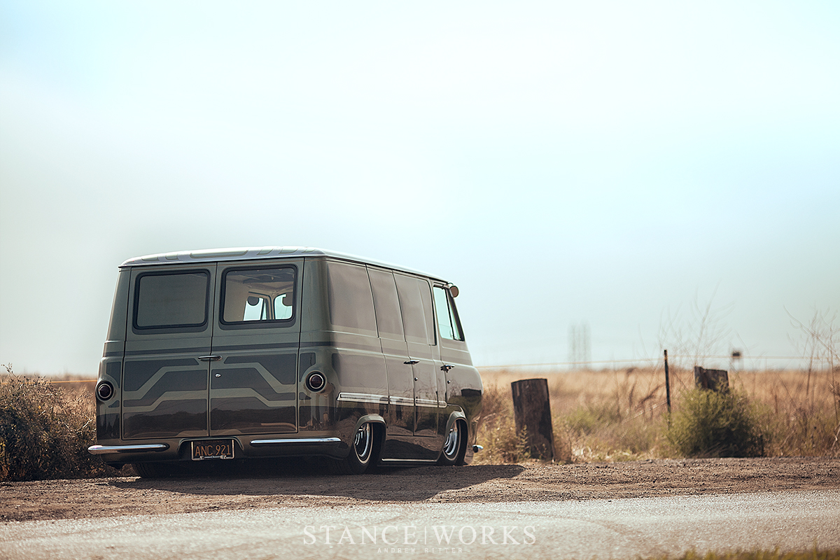

Deciding where to start when it comes to dissecting the intricacies of such a build is nigh impossible. Bits like shaved badging and a lack of signal lights may go unnoticed to some and appreciated by others, while the custom split bumpers and the shaved external door hinges are sure to leave enthusiasts both drooling and perplexed. Floating headlight bezels, the Pontiac tail lamps, and even the (not so) simple straightness of the body panels are all touches of perfection, and surely set the benchmark not only for vans, but for trucks and even custom cars as a whole. And then there’s the paint…
Tim Conder was entirely unconvinced of Coby’s choice in Green Tea Metallic as a base color, but after significant back-and-forth between the duo, Tim penned out the ultimate Larry-Watson inspired paneled paint job. Asymmetric from one side to the other, Van Go’s line and panel work are unique and world class, and accentuate the Econoline’s lack of doors on one side. A vibrant metallic shimmer sinks deep into every panel, and the roof’s design work alone leaves nothing to be desired, straddling the line between hotrodding, lowriders, and Kustom builds from the ‘60s.

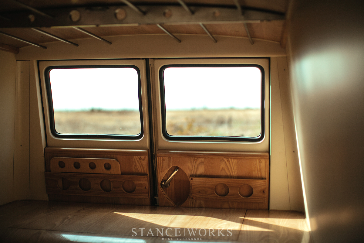

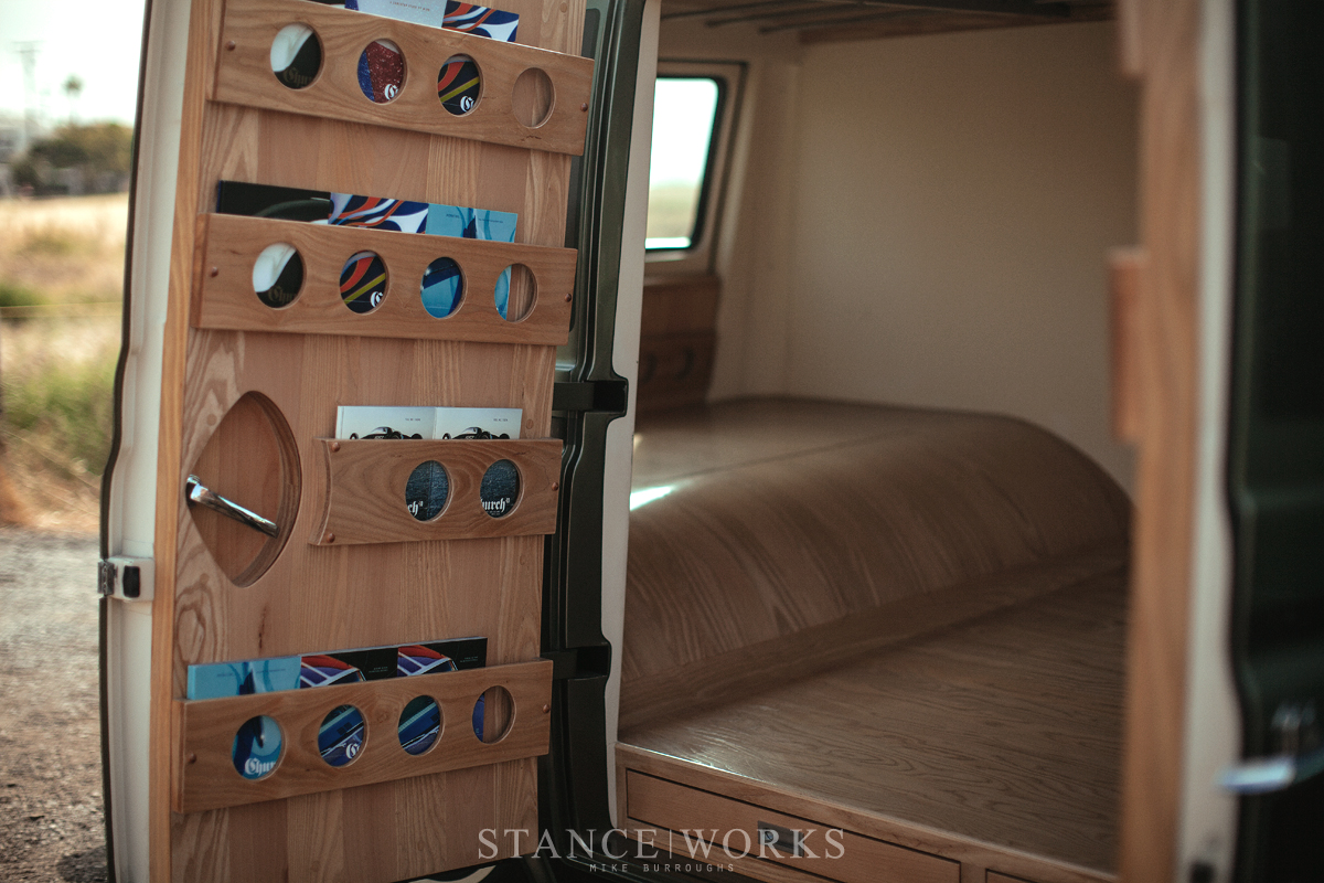

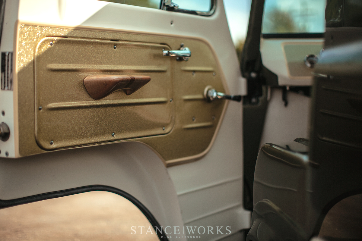

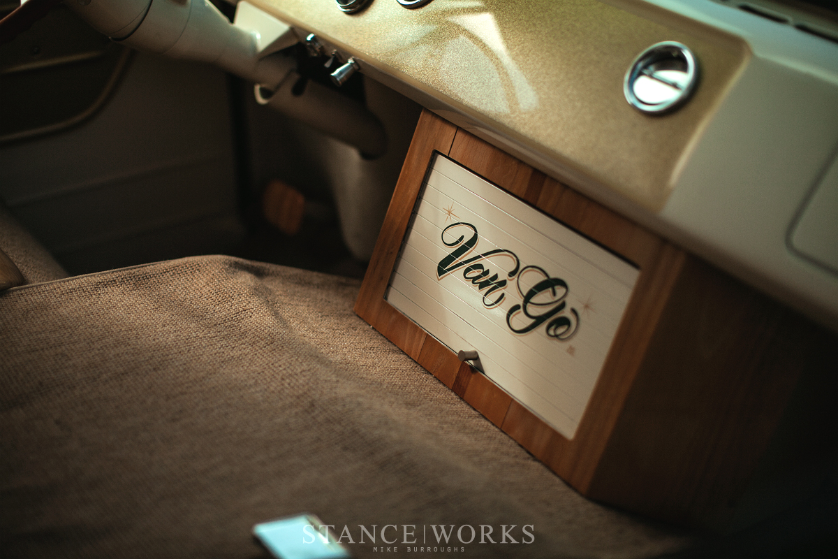

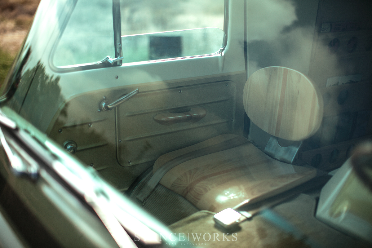

For the inside of the truck, master woodworker Pablo Perez was brought in to shape the interior and cater to Coby’s vision of an Eames-inspired midcentury-modern cabin. Everything serves a purpose, from the stainless steel roof ribbing that supports t-shirts at the swap meet, to the door-mounted shelving that holds is copies of the wonderful Church magazine. Custom pull-out drawers hold art prints and more, and everything is sculpted beautifully, even the Eames “Potato Chip” style seats at the front. The engine is housed under a custom cover, and even the floor itself flows from front to rear, without a right angle to be found.
