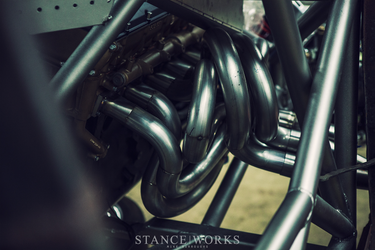

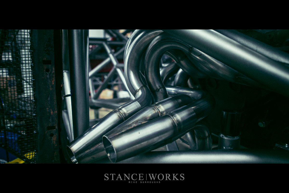

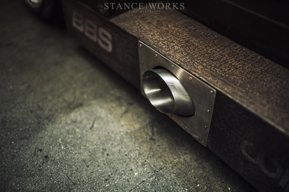

First and foremost, it was a requirement that the build remain a secret. He was welcome to share that he was working on "Rusty," but nothing more. That was perhaps the easiest request. Following that, the car had to remain at our shop, as there'd be no time to take the car anywhere else to have the work done. Robert would effectively have to move into the shop until the project was finished. Next, I outlined what exactly I was after: an equal-length bundle of snakes, latched to the motor. 6 2" primaries with 2 3-to-1 collectors, merged later into a 4" outlet through the rocker panel. A simple long-tube setup wouldn't suffice, and he understood. Lastly, I gave him a timeline: "The car has to leave for Las Vegas in just 6 days."  Where most fabricators might scoff at the level of work in front of them, Robert only said with a resounding smile, "Alright, let's do it."

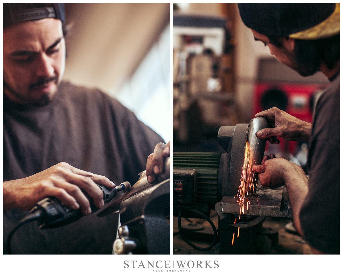

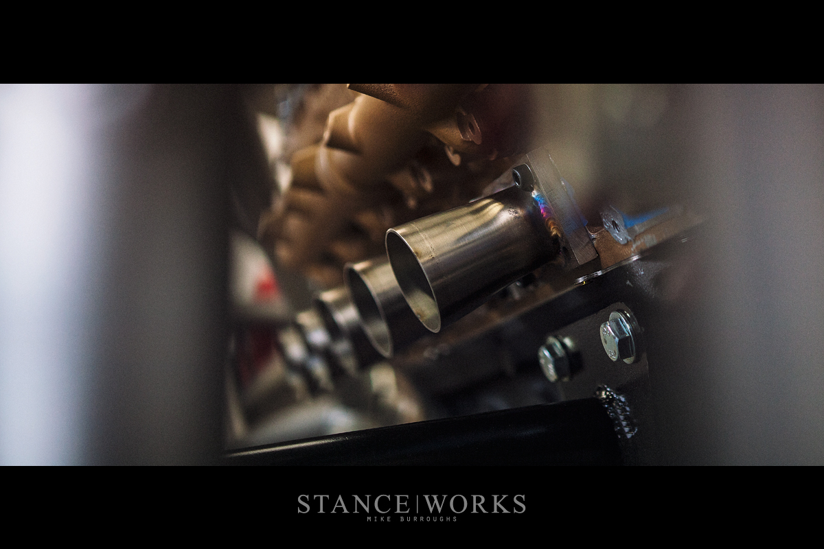

Over the next six days, I watched as Robert chopped his way through tube after tube of 304 Stainless. He began by making the flanges, built to mimic the factory counterparts, only port-matched to the head. From there, he custom-shaped the mouth of the primaries, formed to match the hourglass-esqe ports precisely. It was abundantly clear that Robert knew what he was doing, and it proved hard not to stop and watch him work his magic - there was still work to be done on my part.

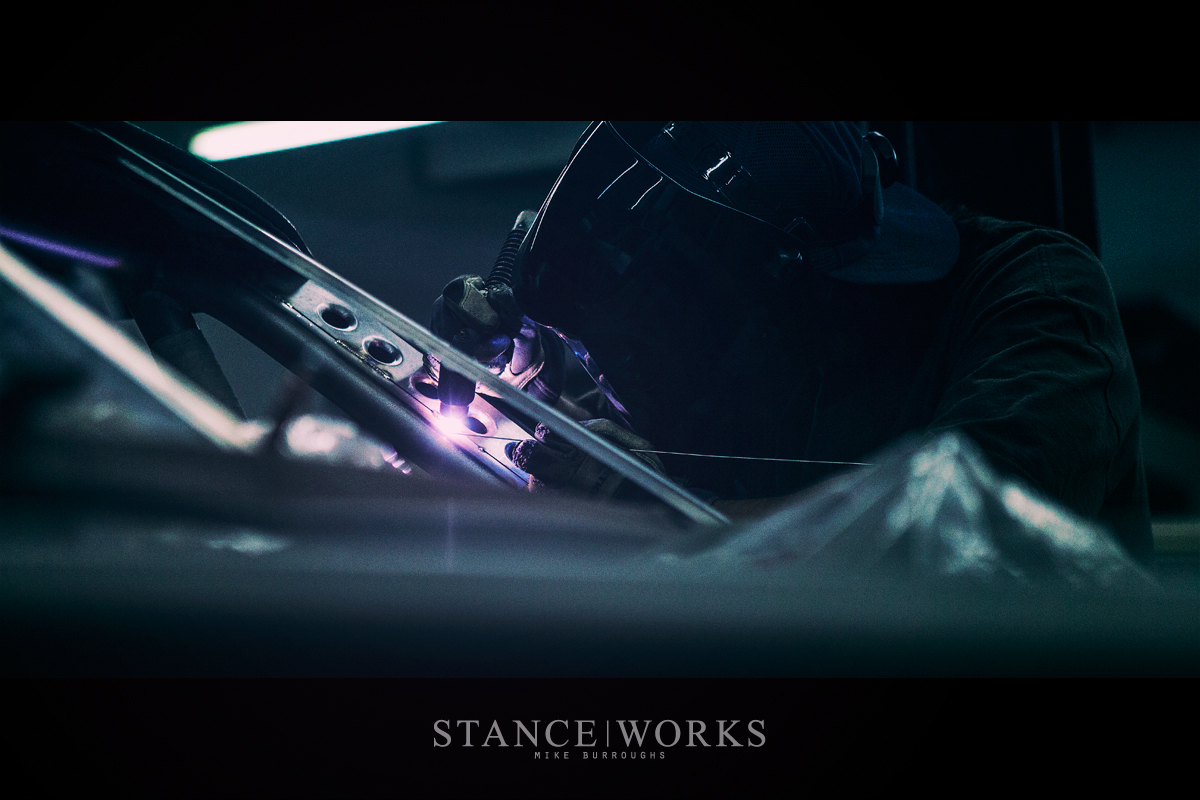

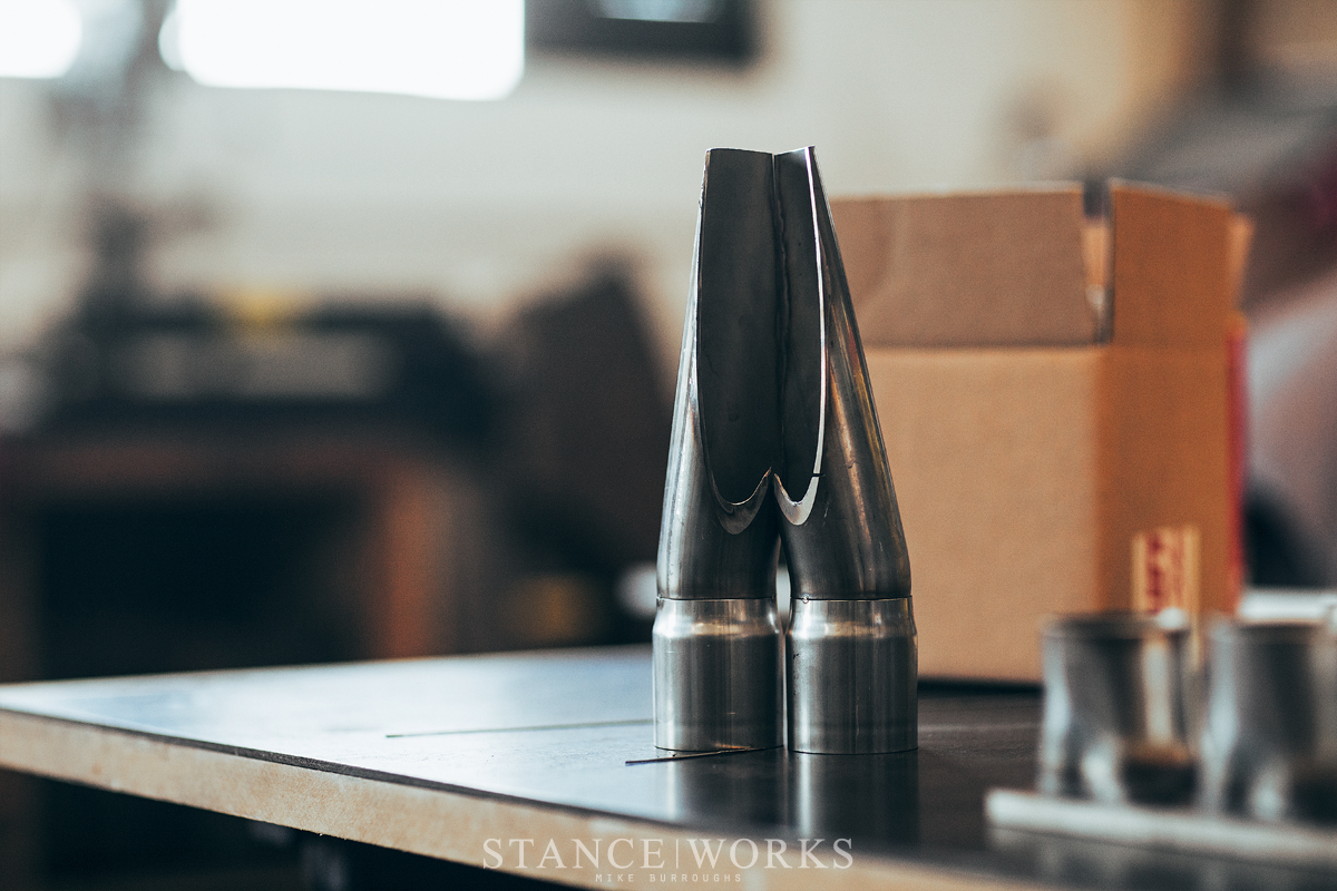

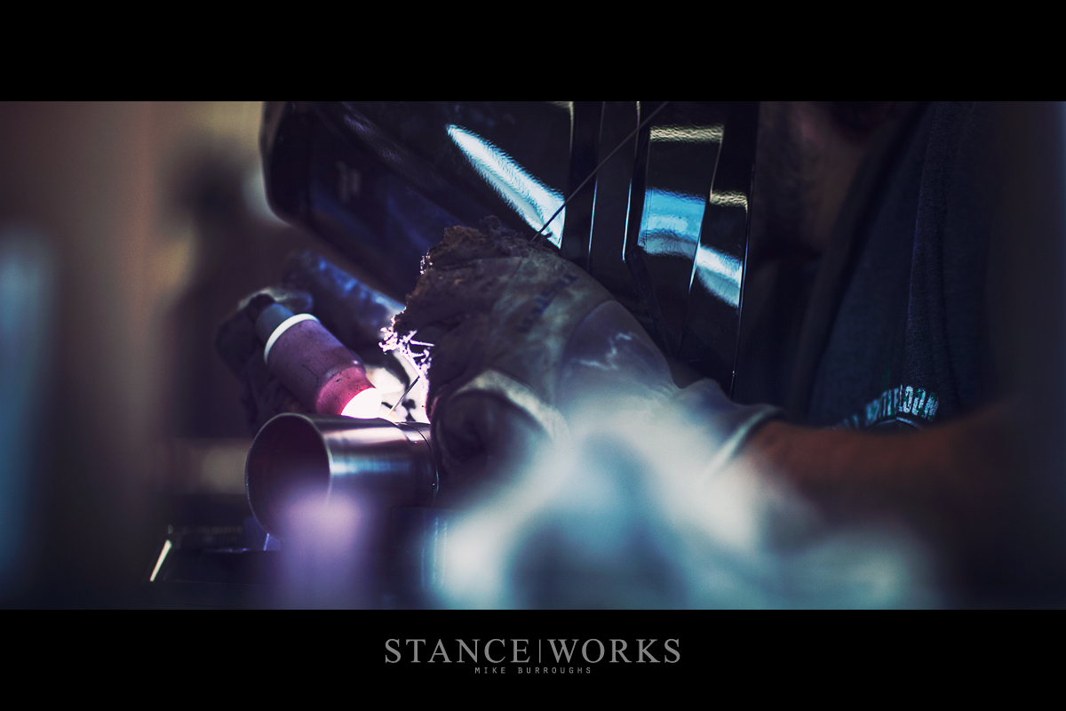

I expected Robert to use some off-the-shelf parts to make his job a bit easier, but instead, he opted to fabricate everything, including the two 3-to-1 collectors and the remaining 2-to-1, from scratch. The process, for the uninitiated, involves merging 3 pipes into one, using precise cross-sectional cuts to mate the surfaces. After a day of some crafty welding, Robert had nearly every piece needed to build the exhaust, and moved on to routing the primaries. Robert and I looked to a number of classic race cars for inspiration on how and where to route each tube, how their paths should interact, and what made the best use of our available space. We both agreed: passenger foot room be damned, there's nothing cooler than a truly spectacular header.
At just 24 years old, Robert's talents surpass his years, leading me to ask about his automotive roots as we worked through the week. Robert's origins are in the world of mini trucks, where at 17, he picked up a welder and built his first ride. The suspension and chassis work involved in the world of slammed trucks dwarfs the effort it takes to slam most cars, but Robert's the kind of guy to dive in head first, and its clear his commitment at a young age has paid off. After mastering MIG, he moved on to TIG welding, known for its significantly steeper learning curve; however, where most struggle, Robert was a natural.
His talents lead him to live the fabricator's dream, working for no one in particular, "freelancing" his talents out to shops throughout Southern California. The concept of a "9 to 5" is a distant thought, instead tackling projects that pique his excitement and interest. Luckily for me, Rusty fit the bill, and the product of Robert's work on Rusty may very well be one of my favorite pieces on the car. While it's easy to fall in love with more stand-out pieces, such as the wheels or the engine as a whole, Robert Chavez's headers blend craftsmanship, design, art, and talent into a piece that is entirely unique and one-of-a-kind.
