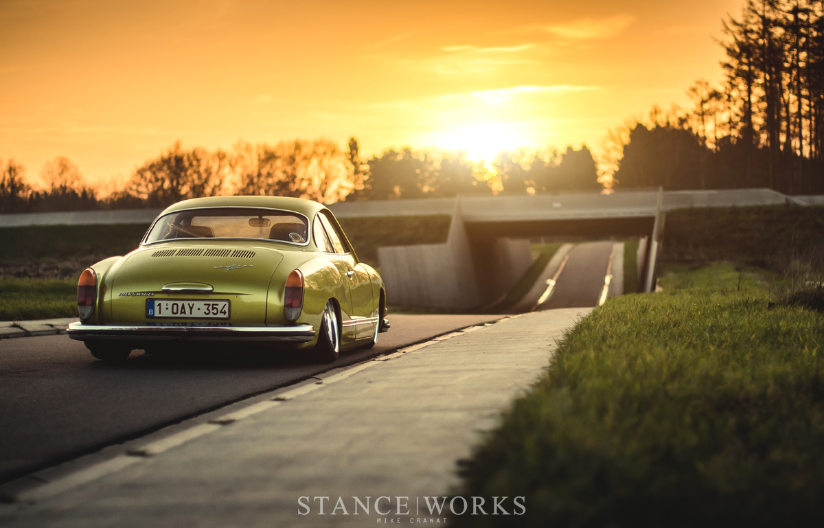

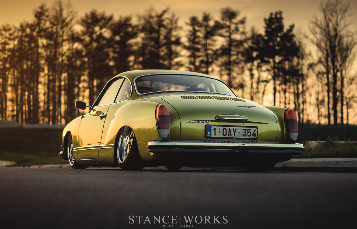

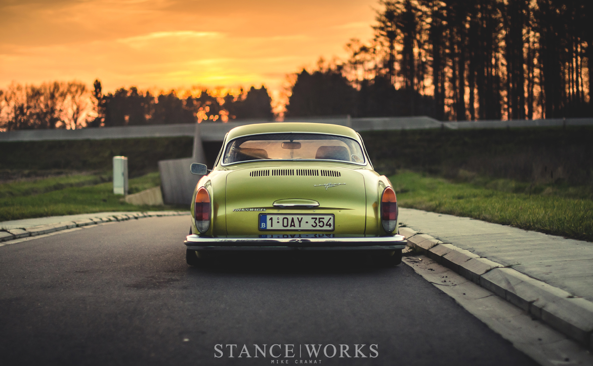

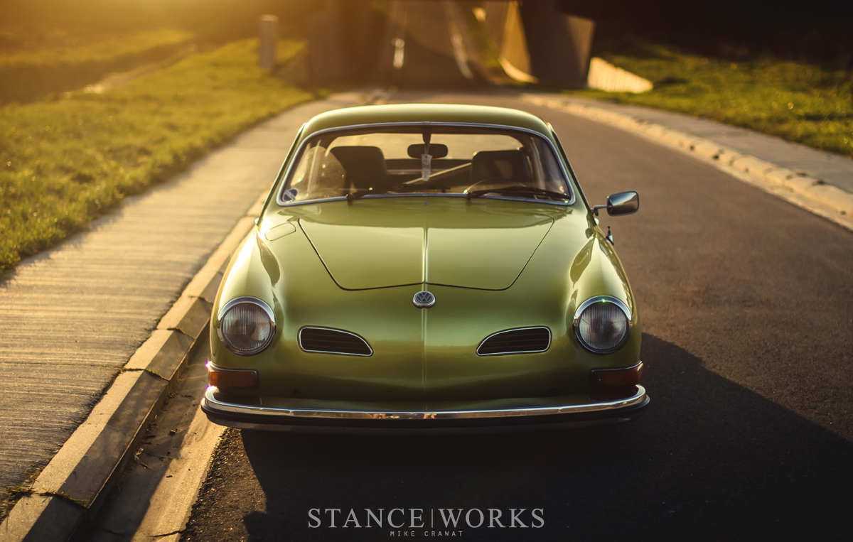

Nicolas’s ownership began with the essentials: returning the car to the road. Now fitted with a 1600cc motor bumped to 1641cc, the Ghia has some impressive scoot. A W100 camshaft, lightened crankshaft, and upgraded rockers make up for factory internals, and an aluminum crankshaft pulley, stinger exhaust, and an electric fuel pump help with output and reliability, and sound.

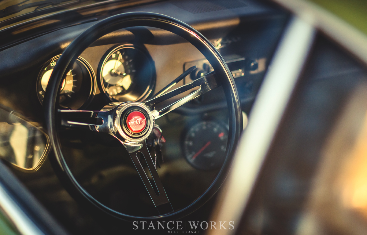

A BugTech short shift kit plumbs input from the engine into the cabin, which Nicolas has filled out further. A custom roll cage, while it eliminates use of the back seat, stiffens up the car, simultaneously adding a glint of safety to a car built in an era when crash test standards were in their infancy. Simpson 5-point harnesses go hand-in-hand with the cage, and subtleties, such as Porsche 912 gauges give the interior its final touches.

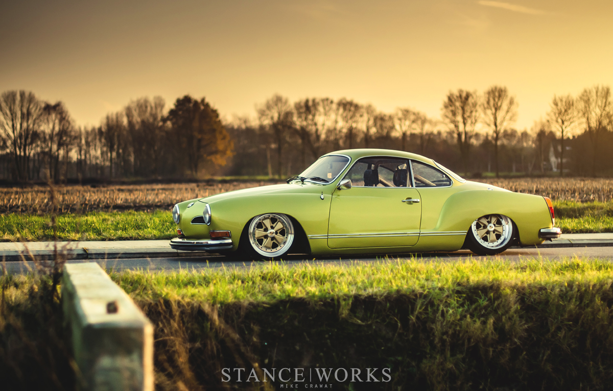

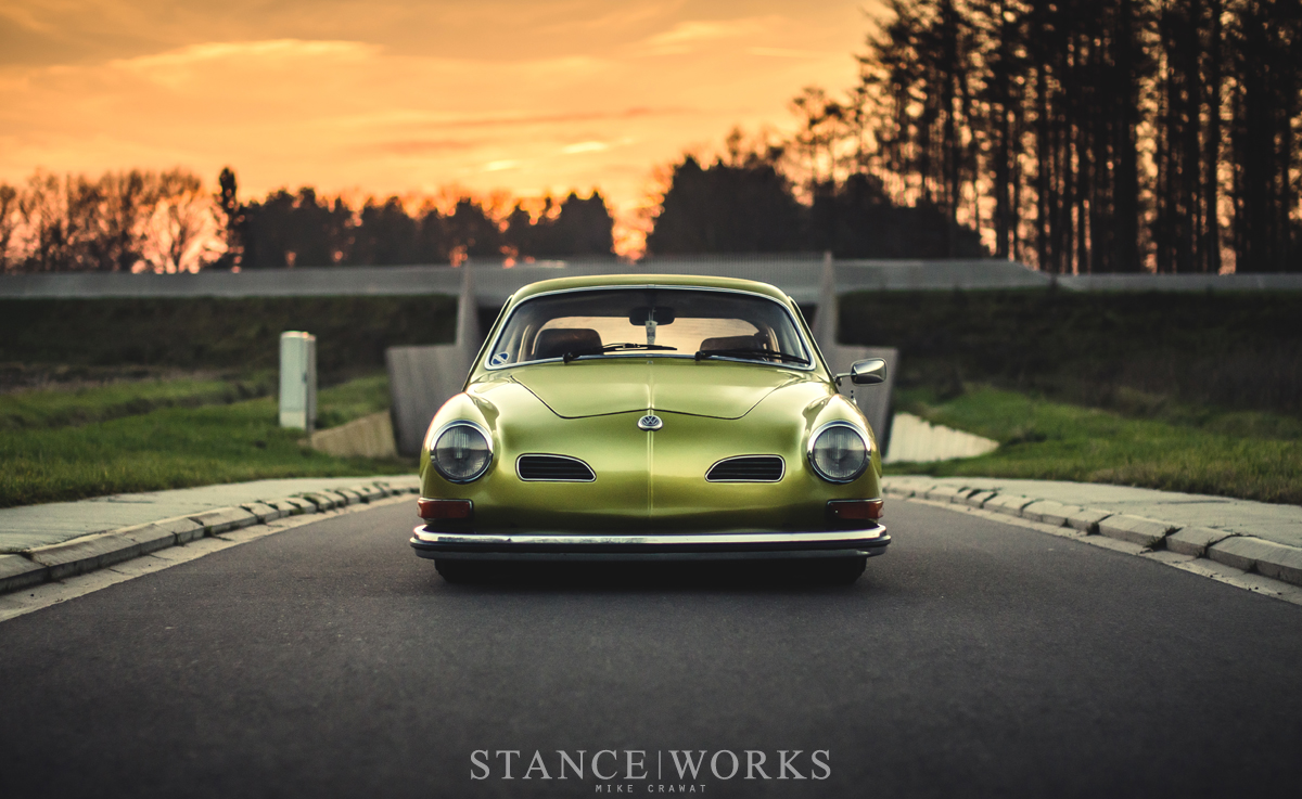

The aesthetics of the car is where Nicolas established his primary focus. Having fallen in love with the color, Nicolas wanted to see the car’s visuals through. Nicolas began with the floorpan while the car was disassembled, raising it a full inch for ground clearance. For suspension, he opted to forgo air ride, favoring old school air-cooled methods. The front beam was narrowed 2.5 inches for clearance, and dropped spindles brought the nose down. In the rear, only modifications to the spring plates were required.
Perhaps the focal point of Nicolas’s build is his choice of wheel. After establishing his own wheel refinishing brand, “2Polished,” Nicolas sought to establish and showcase his talents with a custom set of multi-piece Porsche Fuchs; a fitting pair due to Porsche’s initial involvement in the creation of the Volkswagen Type 1, and Karmann’s 911 design work. Originally built from 16″ cast one-piece Fuchs, the wheels were turned down and machined to accept 3-piece wheel hardware. Stepped up to 17″ in diameter, and widened to 7.5″, the final measurements for the set landed at ET35 and ET55. Nicolas proceeded to finish the centers in classic BBS silver, paired with polished hardware, and lastly, wrapped with 165/35 and 195/40 tires.
