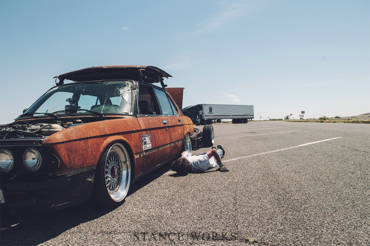

A bit further into our day, things escalated, further and further. Rusty’s sputtering issue returned, this time worse, killing the car’s ability to drive. What we initially thought was overheating was deemed as something killing spark or fuel, but we struggled to solve it. All we could do was wait, so we did. We broke down again, this time due to an idle control valve. Again due to an AFM. Then once more, where I changed the clogged fuel filter on the side of I10 under the desert sun. Then we overheated. And then again. We made 15 minutes of progress every two hours, and the sun was beginning to fall in the sky.

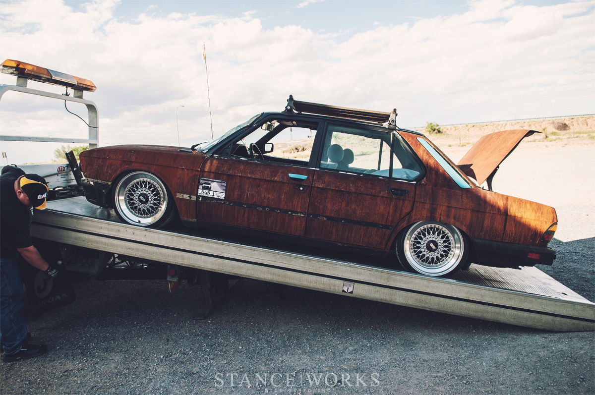

Eventually, we broke down for our final time. Coincidentally, it occurred on I10’s exit marking the Continental Divide – perhaps it was fate attempting to keep us from making it to the West Coast. Unable to solve our issues, we called up AAA, asking for a flatbed tow for the remaining 220 miles to Tucson.

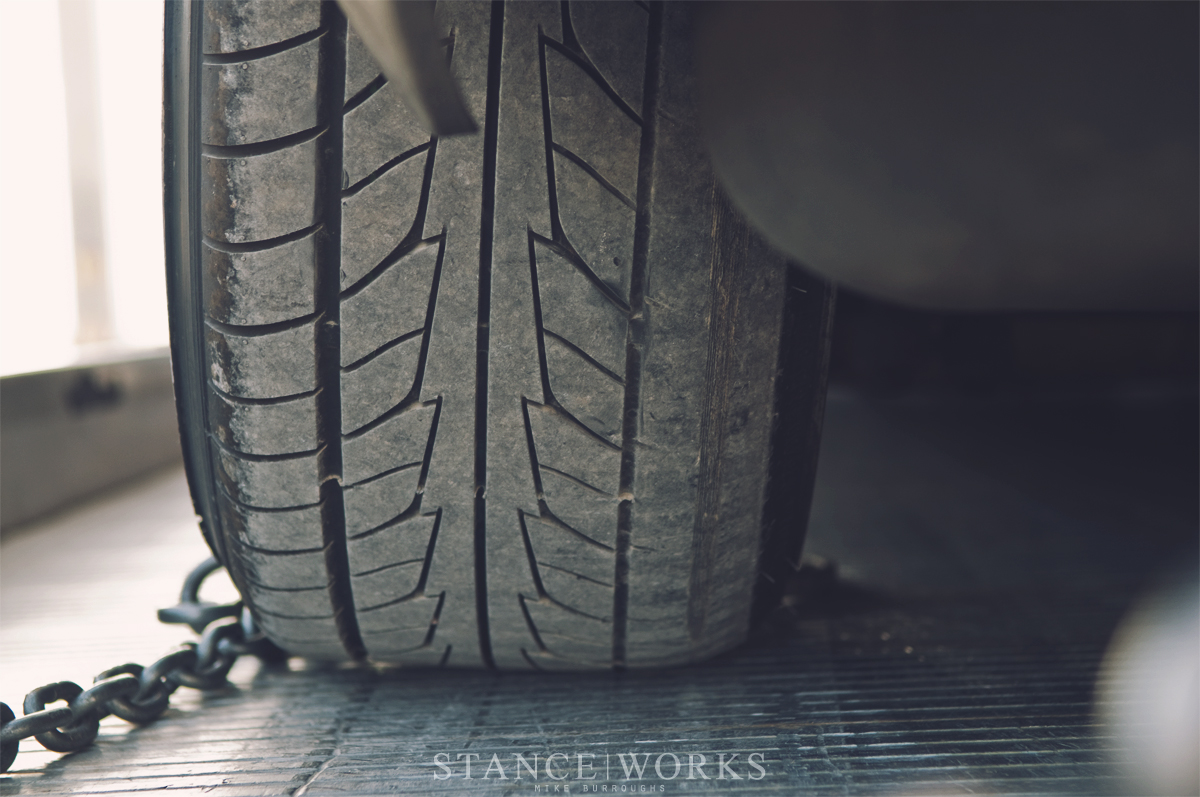

Once we pulled the car onto the flatbed, we found the silver lining of the situation – both rear tires were down to the cords, and had we made much more progress, they were sure to pop in no time. A blessing in disguise, if you will. Further, we had hoped our tow would cut down on issues, and, in light of admitting defeat, get us to Tucson in a hurry.  But the story doesn’t go that way.
With just 40 miles from our breakdown point until the AZ border, we encountered a dust storm – a severe one, which our driver was unwilling to pass through. The progress we had hoped for was halted.

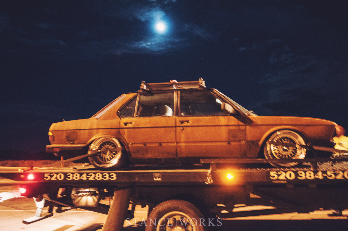

Eventually, however, we did make it to the border. Things felt good! We were finally going to “make it.” Until our tow truck driver informed us that local laws prevented him from towing us into the state of Arizona. Instead, he dropped us off at the closest rest stop, where we sat waiting for our next car recovery  truck to arrive.
The sun had gone down, and Andrew and I continued to wait. We practiced “whipping” coke cans off the hood of the car with a torn semi-truck serpentine belt we had found in the parking lot. Boredom was at its peak, progress was at the opposite end of the spectrum, and our spirits were slowly falling. Eventually, our new driver arrived, and after some careful loading up, we got on the road. We were ready to make it to Nic’s place.

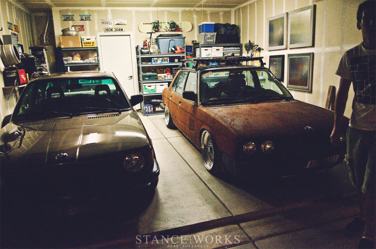

After being up for nearly 24 hours straight, we made it to the Fosters’ place. Nic and Steph were awake to meet us, sometime around 2:00 am. We were beat, dirty, and ready for some much-needed rest. Steph was kind enough to give us her garage spot, which gave us a place to repair everything needed on the beast.

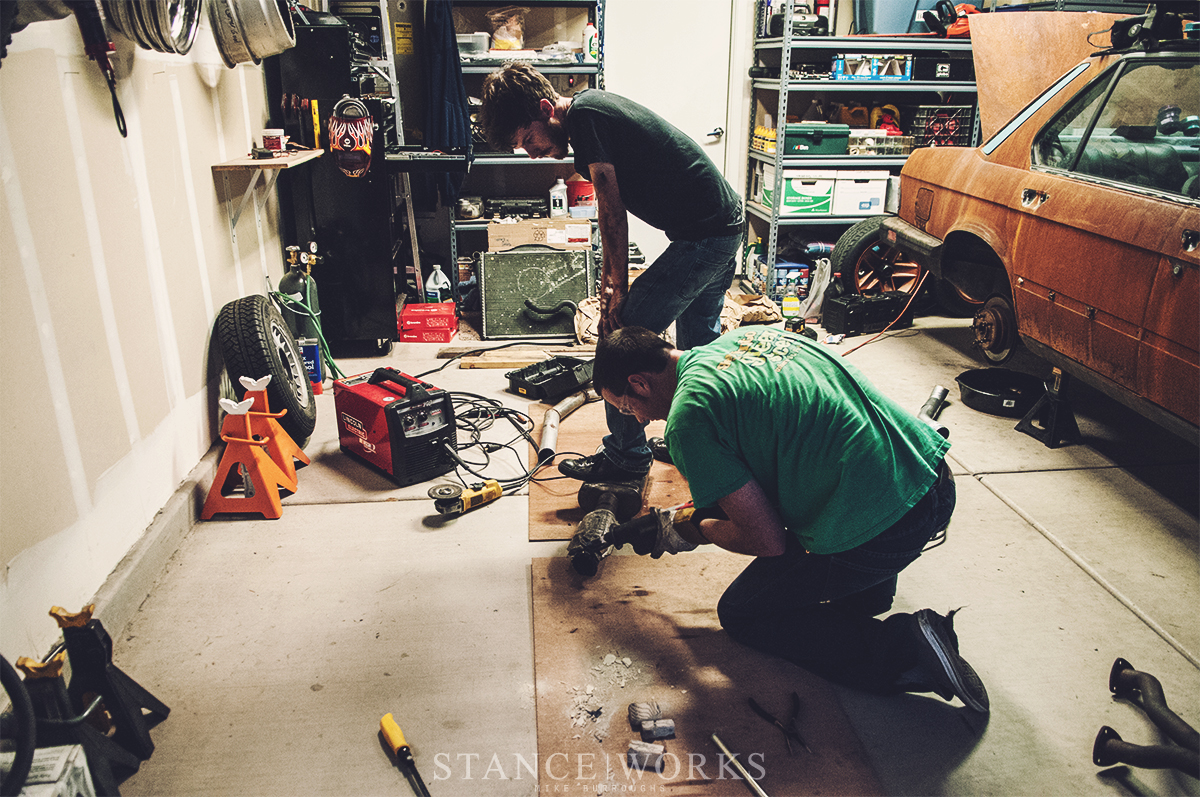

The next morning, we entered the garage to assess the damage. We put Rusty in the air, and climbed underneath. It was to be a patient several days of overnighting parts, making repairs, and doing our best to make the car roadworthy – truly roadworthy – once again.

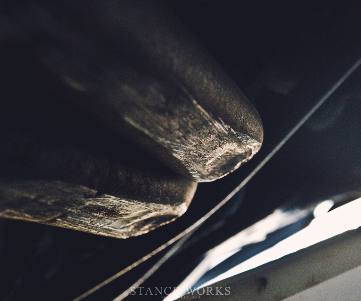

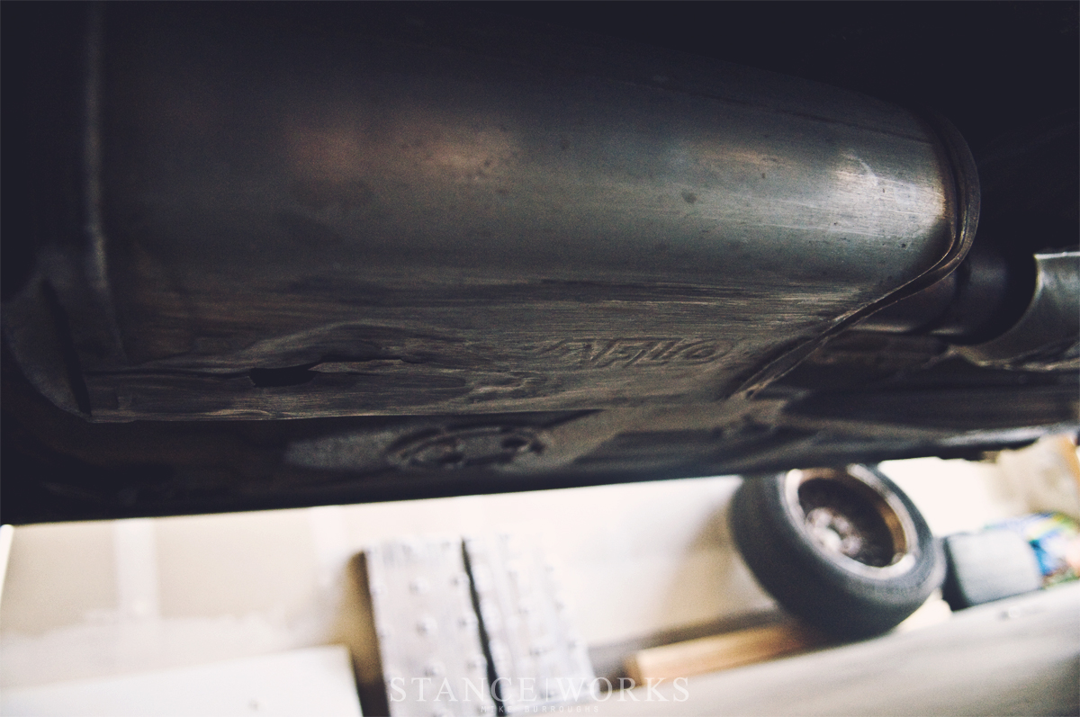

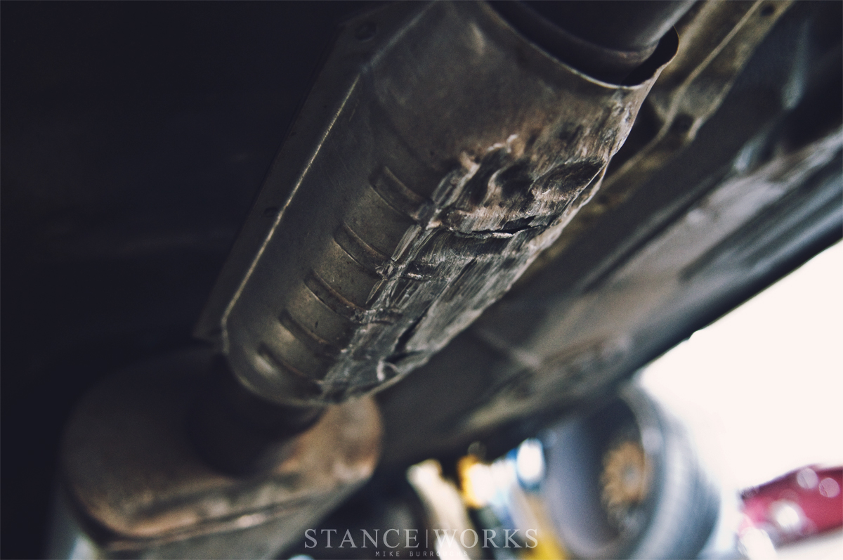

With all of the exhaust troubles we had, we knew the under side of the car was going to be in rough shape, but we had no idea we’d have to fix more-or-less everything from the downtube back. The lower bends of the headers were smashed and dented in, ground down to a paper-thin skin of metal. The catalytic converter was gouged, crunched, and resembled a stomped soda can. Lastly, the muffler was ground down, through the skin, with holes on seemingly every surface. The tail end of the muffler had been pried open, meaning a good bit of work was in store.
And, because I’m entirely unable to work on a car without covering myself in grease and grime, I needed a hose-shower after giving Rusty the once-over.

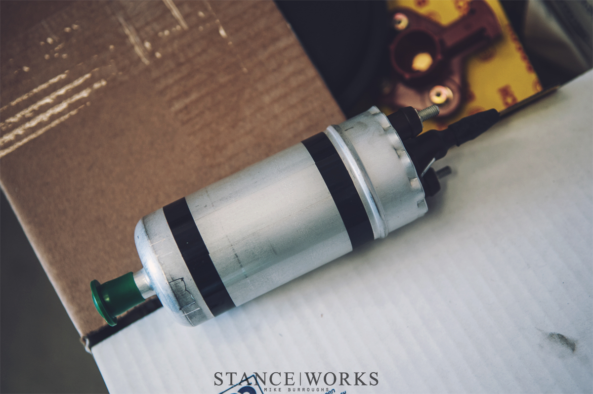

After testing each component of the car, as well as examining everything thoroughly, we ordered the necessary parts. The main culprit of our issues stemmed from a dead in-line fuel pump. The heat and load given to the in-tank pump caused it to exceed its duty cycle, leaving us stranded on more than one occasion. The car’s cap and rotor were worn out entirely. I ordered up a new set of rear tires, and a new power steering line to replace the patched part, and the rebuild began.

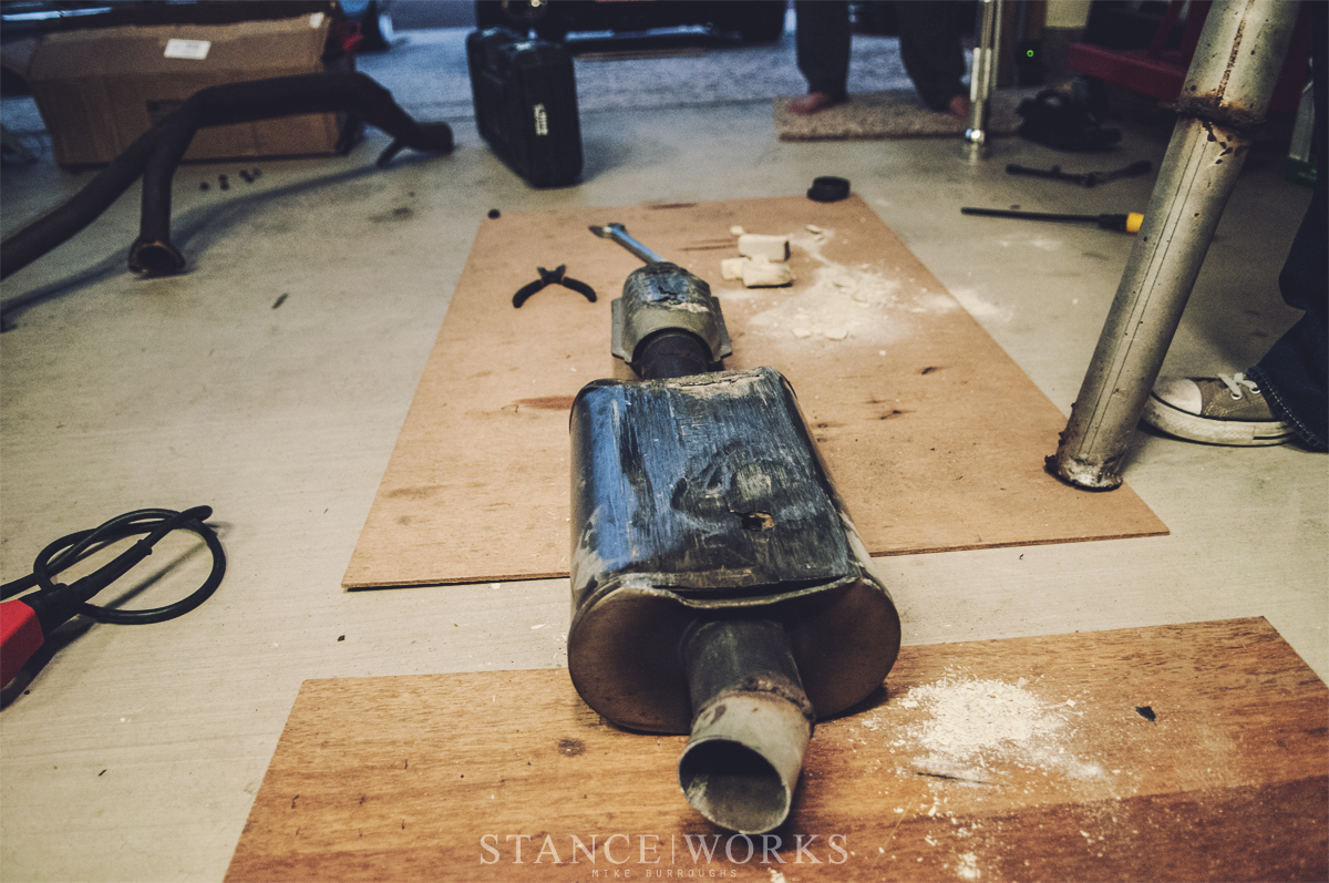

From there, we went after the exhaust. Nic and his welding skills, far superior to mine, were the saving grace of our trip. After hacking the all but destroyed exhaust off the car, we got to work chopping, patching, and rebuilding the crude but sufficient pipe.
Nic pulled together his spare scrap metal and devised a series of plates and patches to make the exhaust roadworthy once again. The first of many patched the main hole in the muffler. From there, we attached a skidplate, which helped seal things up, and provide extra protection for further driving.

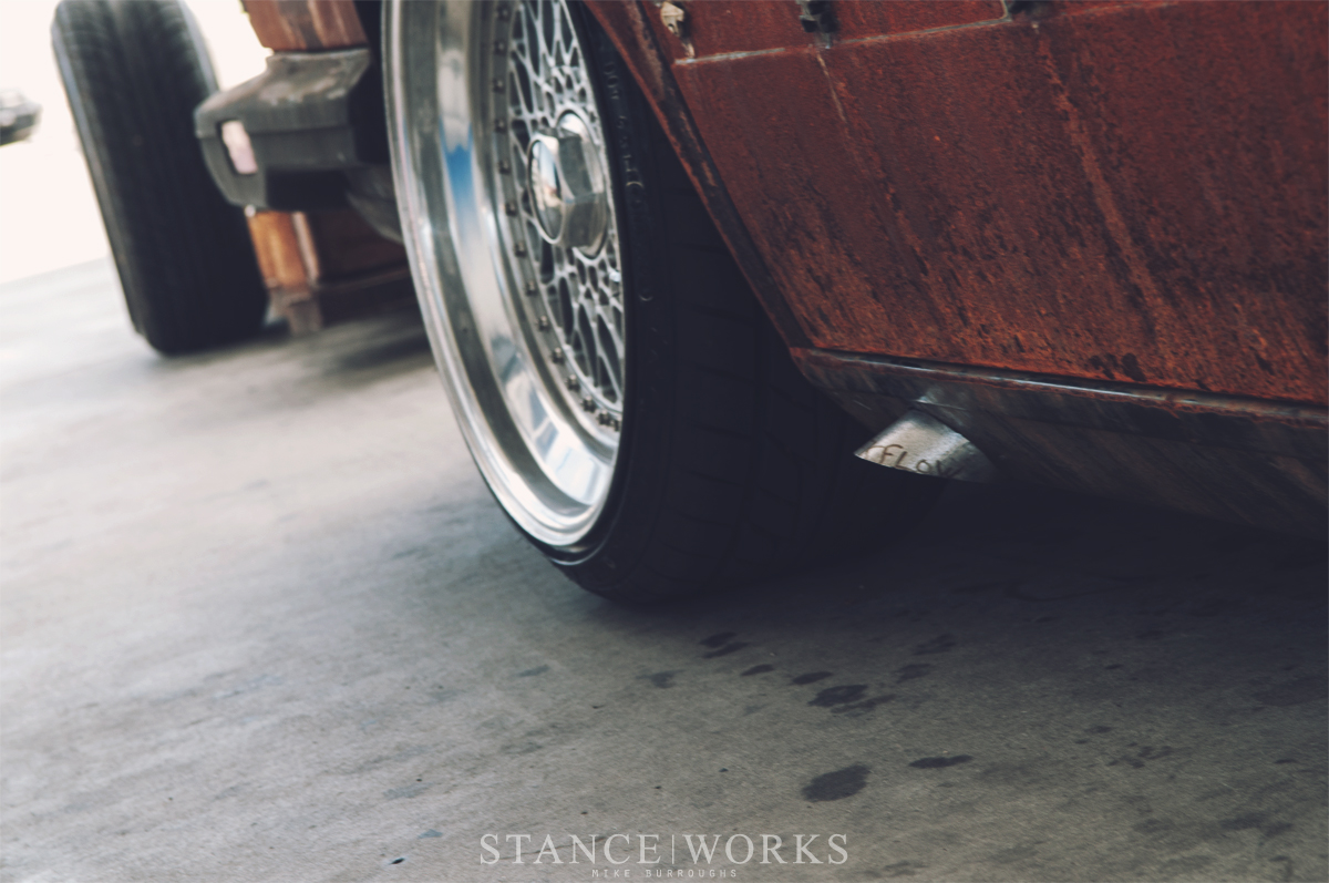

Nic, with the finished product, which we later deemed “Battle Ready” with a sharpie. Some teeth added in to the front of the plate gave for a bit of fun, and attitude – we were prepared to take on anything the asphalt threw at us. Installing the exhaust was a bit of added effort. Aiming to mount it as closely to the car as possible for ground clearance, we routed it out of the rocker panel. Better safe than sorry, we thought! And why not add holes to an already rusty car?

The new rocker-routed exhaust held up well over the harsh roads. It sat above most bumps, and when contact was made, a hearty thud occurred as the load transferred to the floor of the car – exactly what we wanted. The lack of a giant hole through the muffler helped the sound as well.
