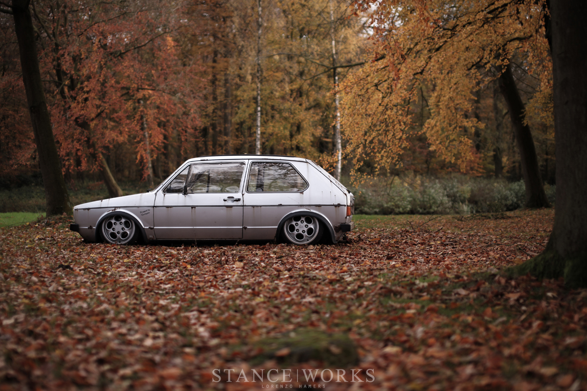

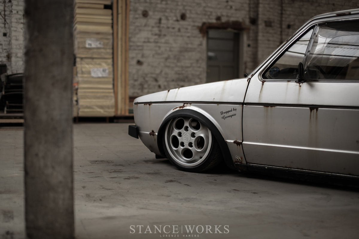

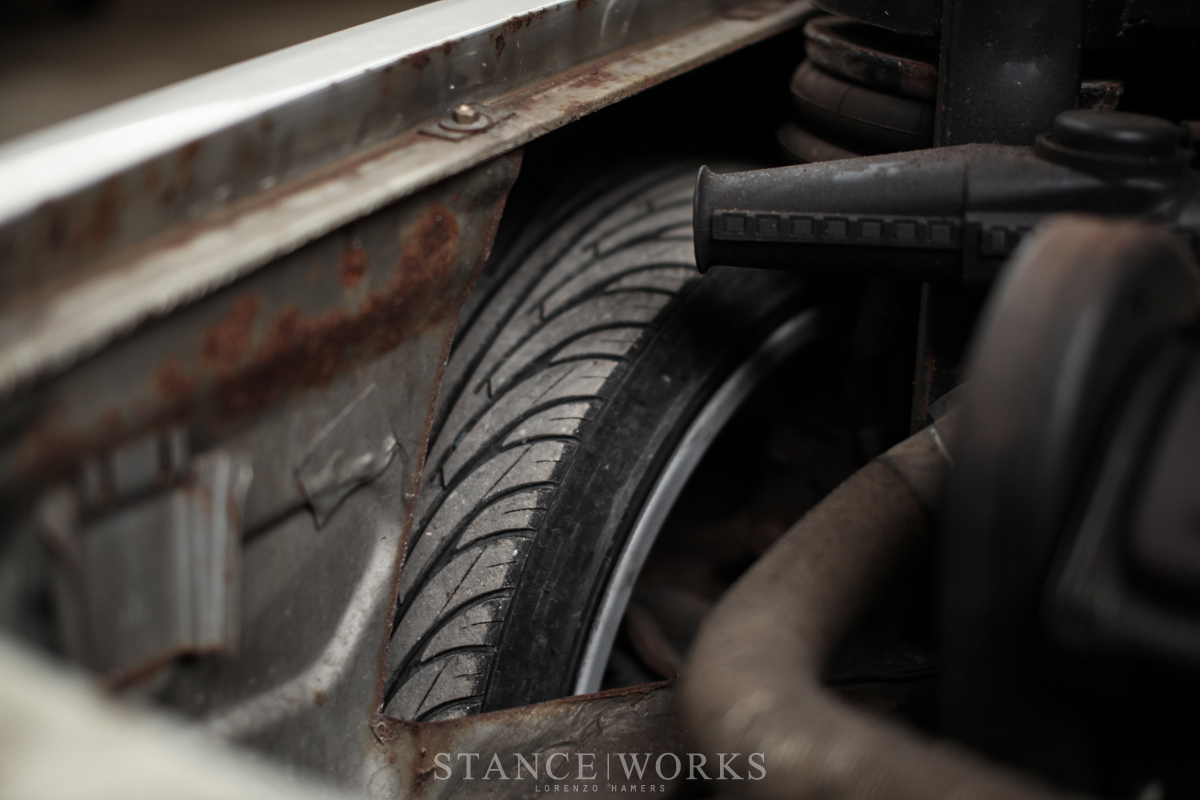

Steven began with the front of the car. The inner metalwork was cut out to make room for the rather large 16" Porsche phone dials, as well as the new air suspension. The air struts themselves brought the car down, but not nearly enough; after shortening the struts further, the real work began. After very careful and extensive measuring, each suspension pickup point on the car was cut out off the car and moved upwards just over two inches. This allowed Steven's MK1 to retain the correct geometry for driving, while simultaneously allowing it to sit two inches lower than it had before. The remaining pieces of the car that sat lower than the engine were modified, removed, or simply cut away, all in the name of pushing the car as close to the asphalt as possible. A new steel subframe was built to keep everything in order.
Slammed mk1 phone dials slammed mk1 suspension

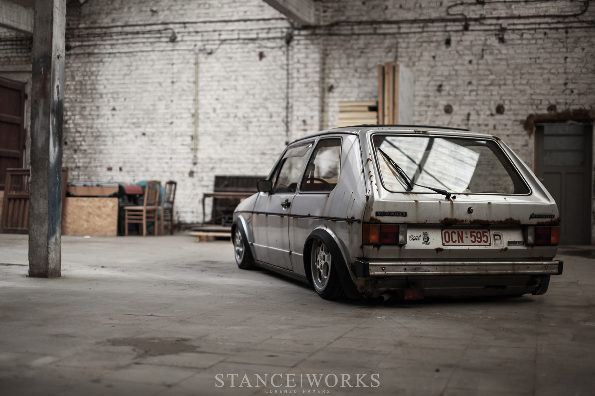

The tail end of the MK1 received a very similar treatment. The wheel wells were cut away to allow the car to sit lower, and the gas tank of the car was removed, and an aftermarket one relocated, to allow for the rear beam to travel without interference. The brake lines and fuel lines were all reconfigured, and then the air suspension was installed. The end result is a car that has the suspension geometry, and clearance, to drive just fractions of an inch off the ground.
slammed mk1 airride bagged

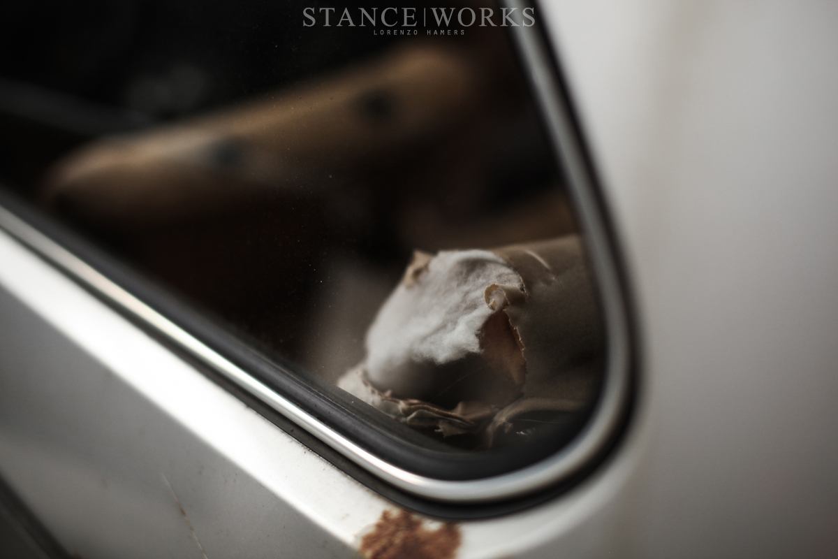

One important factor to the car for Steven was that from the outside, aside from it's absurdly low ride height, one would be unable to tell that the car had been tampered with. With that in mind, he kept the original, worn-out interior, but making the back seats fit with the changes he had made to the wheel wells and rear flooring proved to be a struggle.
