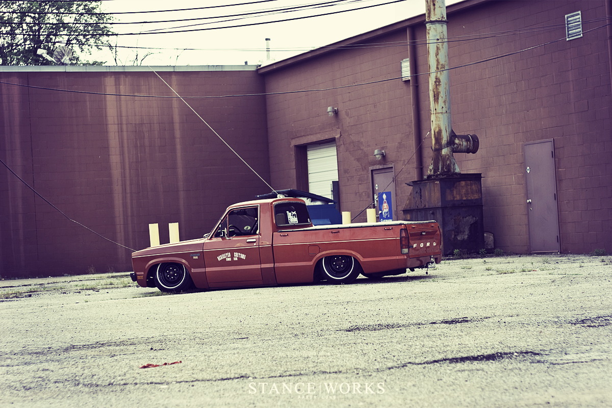

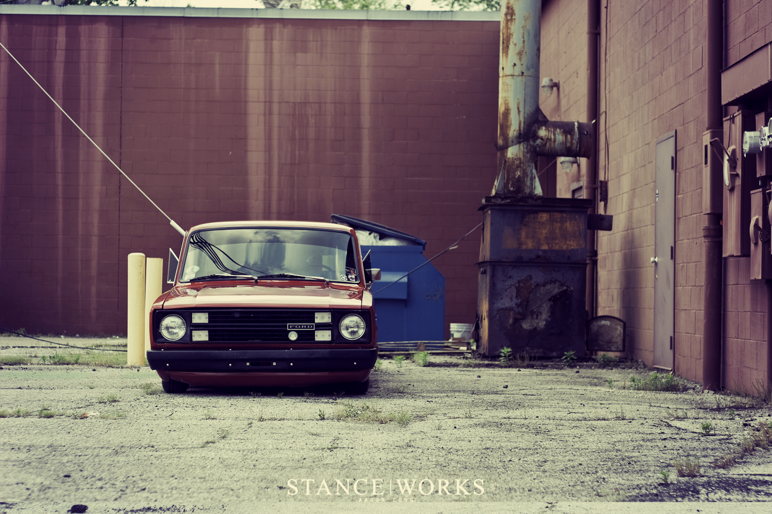

The first thing to tackle was, of course, how to get the car friendly with the pavement. Considering this was still going to be used daily as a parts runner, air suspension was chosen. Getting a truck to lay out isn’t as simple as most unibody cars, and requires more than simply bolting in a made to order strut kit. That said, the front of the Courier is straightforward, requiring only custom made brackets for the bags to allow the front of the truck to sit down. Mike, knowing the Ford would see daily use, fabbed up custom shock mounts, and utilized shocks, something that is not always done in the mini-truck community.
To follow, Mike had to take care of the ball joint angle at a lower ride height. Mike accomplished this by taking 20 degrees out of the control arm angle by the simple but effective method of putting a pie cut into the control arm and bending it downwards, followed up by the re-welding of the control arm in its new form. This allowed the truck to cruise along happily at very low ride heights without the strain and premature wear that comes from running ball joints towards the end of their range of motion.
The front end of the truck was now situated, leaving the task of getting the rear to join suit. This is where things start to get complicated compared to the cars most of us are familiar with; the rear of the truck uses a solid axle. With the stock frame, the main issue isn’t the wheels and tires hitting the fender; but rather the axle hitting the frame well before the rear is able to lay out. The solution lies in notching the rear portion of the frame up a hearty 5 inches. Unlike the semi circle notches cut into the frame of cars like Volkswagens that allow a FWD/AWD car’s front axle another inch or so of contact free travel, a truck notch involes cutting out an entire section of the frame and moving it up 5 inches. This is a complicated task and a big undertaking to say the least, but running a metal fabrication shop made the task manageable. Mike wanted a smooth ride out of the truck and went with a 4 link setup to re-attach the axle to the modified frame. The bags in the rear were mounted directly to the link, and again, he created custom brackets to mount a shock to ensure a comfortable ride. The last step was raising the floor of the truck bed to be able to clear the new frame and axle setup, which now were well into where the bed originally resided.
Control over the air ride was done in the tried and true old school fashion of two Viair 480 compressors hooked up to a 5 gallon tank, and management via a pair of 3/8” manual switches. As Mike lightheartedly put it, “no side to side bullshit.” He was building with a purpose. The truck was now sitting how he wanted; however, it left Mike with a shop truck that had a storage-impaired bed. To remedy this, a hitch was installed and sees use quite often, something that is refreshing to see. Mike related “It is so funny to see the looks on people faces when a 46″ tall truck pulls a trailer with 1,500 lbs of firewood,” a necessary task as the firewood is used to heat his shop throughout the winter. Mike also swapped out the truck’s 3-speed automatic for a 5-speed manual, one of his favorite “mods.” He boasts that the little 2.3 will now cruise along happily at 75mph.
