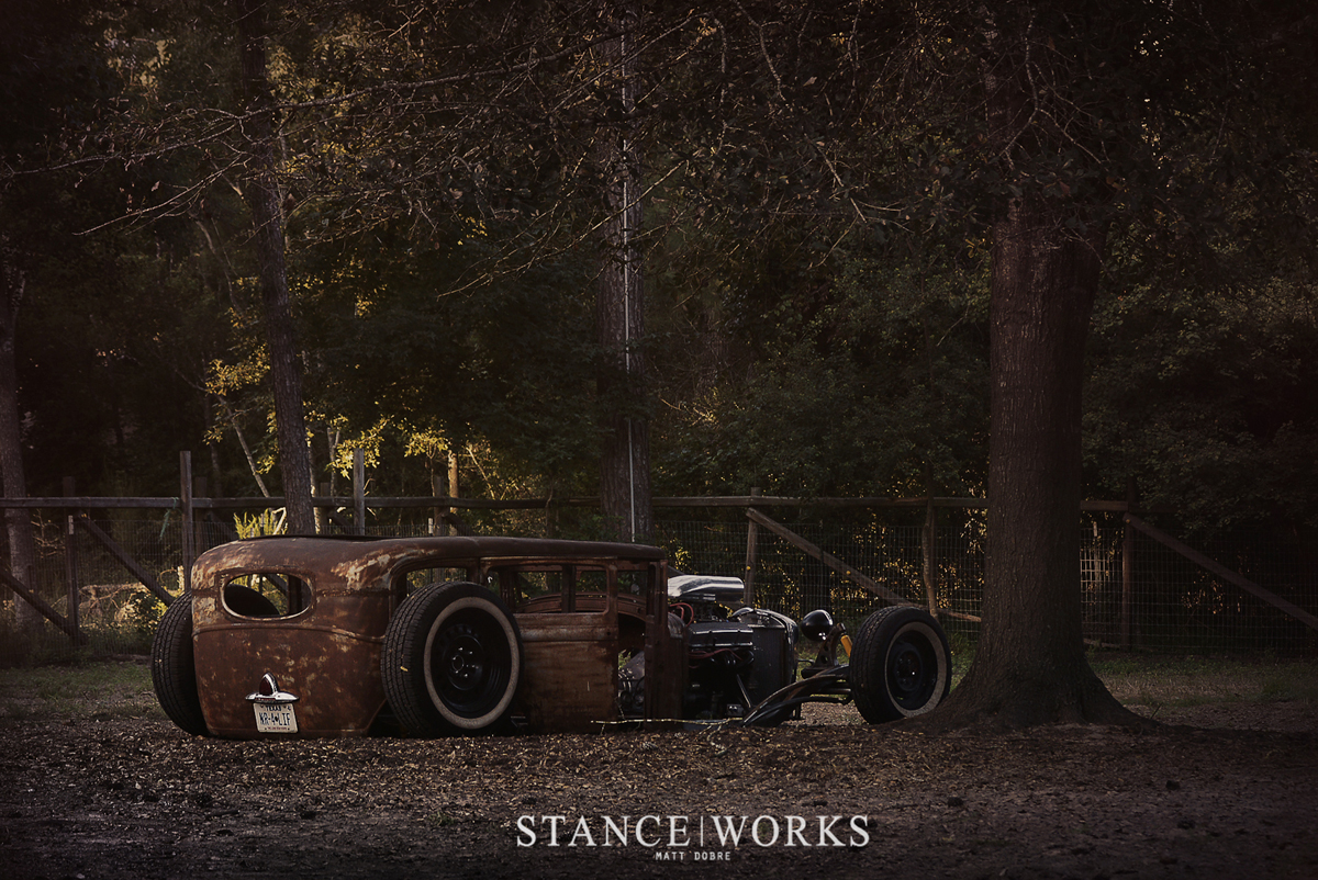

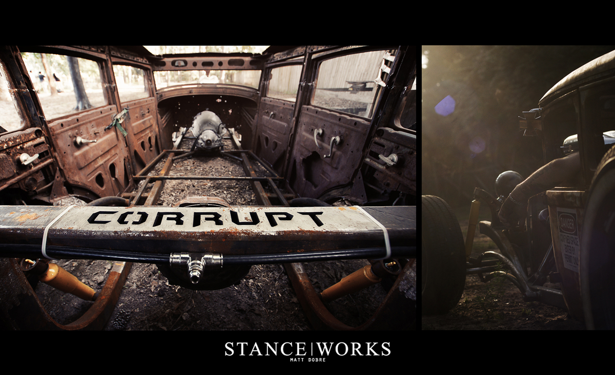

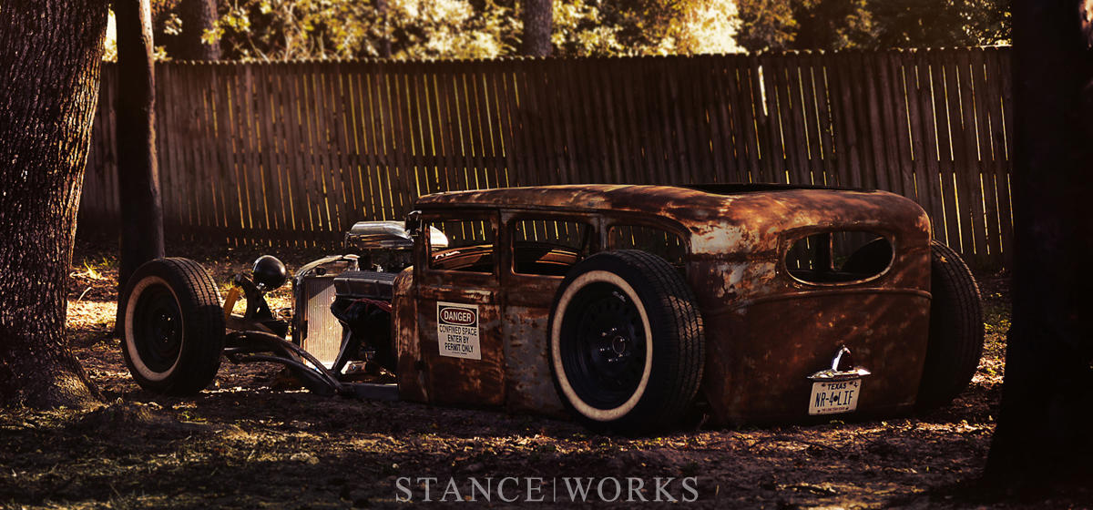

The first on his list was the Plymouth before you. While it's far from done, it's beginning to resemble its final form. The floor of the cab has been cut away and channeled over Brody's custom frame. The height is brought down even further by a rather notable chop to the roof height, and last but not least, air suspension to set the car down on the ground. The rear white walls begin to cover the rear quarter windows once she's laid out; a tell-tale sign of proper hot rodding stance.

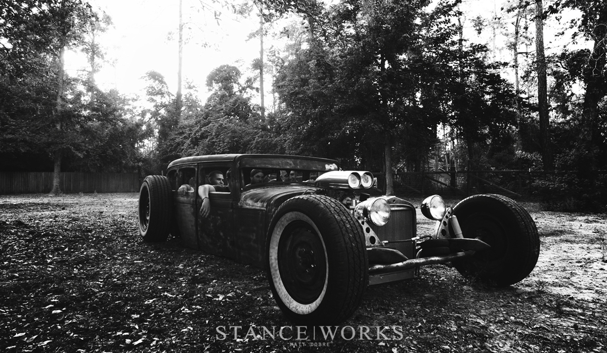

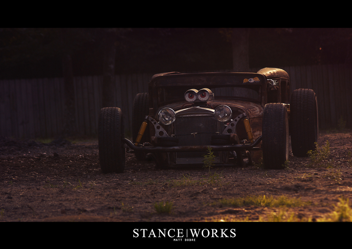

A close inspection shows a unique split wishbone suspension for the front and rear, an obvious custom solution to counter the nearly century-old technology the Plymouth came equipped with. The front uses a slight drop axle with an interesting front kink/sweep paired with bags over top the axle. The result is a pseudo-suicide front end, a very cool and unique solution to an ever present question in how to lower a hot rod.
