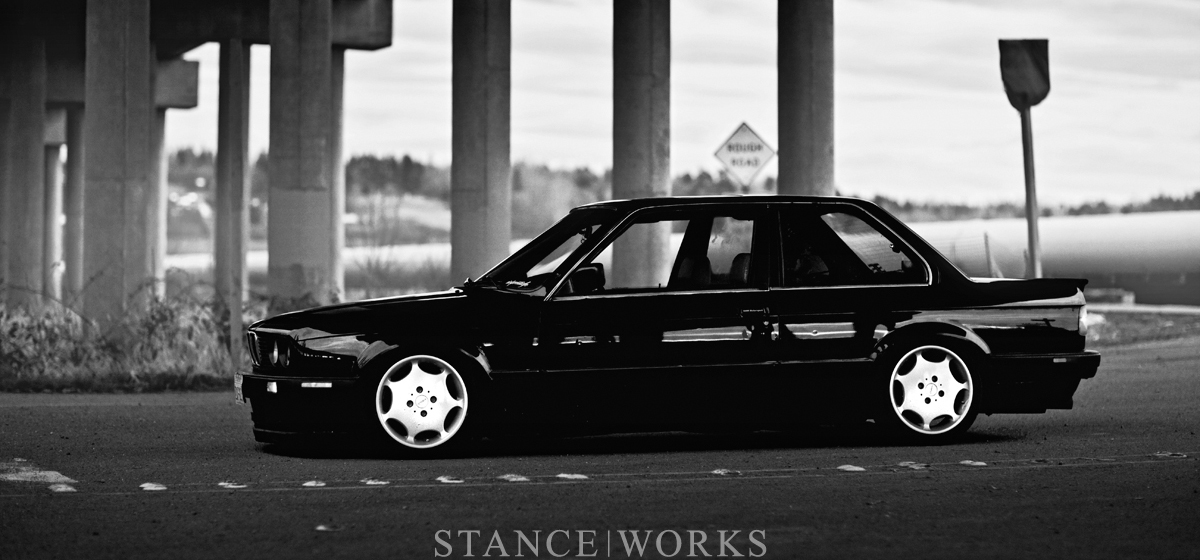

In keeping up with the day-to-day grind here at the STANCE|WORKS HQ, we have decided to keep regular updates coming in regard to what goes on behind the scenes. The past 7 days have been hectic to say the least. This past weekend, I flew to Seattle to see Nic & Stephanie Foster, as well as the rest of the SW|PNW Crew. Stephen joined Nic and I for an afternoon of shooting in what will soon be another SW Feature.
