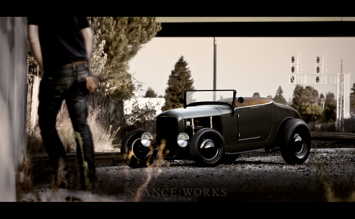

The standard in play is enough to turn ambition into defeat, but that's not a option when challenges have to be met.  The first Ford roadster was produced in 1927, so it was determined to maintain the visual cues of a Model A with the comfort of a Model B. Nic and Zane opted for a Shadow Rods XL27 body which equates to 3" taller, 2" wider, and 4" longer doors all while retaining the overall visual cues of a '27.  The steel body was built with the intention of mating to a '32 Ford frame, which Cotati built in-house.  Remember this is a "fusing of worlds" we are dealing with; bringing modern technology and comfort seamlessly with heritage fit for a museum.

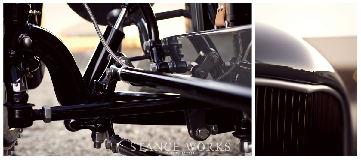

If you are a suspension guru like we are, this is where it starts to take off.   To finish off the custom frame, tubular double cross members were added for rigidity.   A triangulated 4-bar system was chosen for the rear suspension, in helping with getting the roadster sitting right.   Ford originally used "bones" to keep the axles in place, but when people started modifying the frames and lowering the bodies, the bones would get in the way.   To remedy this, a 4-bar solution was developed to allow the axle to move up and down freely with the outer bars pivoting at both the frame and axle, while the center torque arms keep the axle from rotating.  This ensures that the axle doesn't bind under duress.   Bilstein Coilovers round off the rear, mitigating any discomfort that might be found on the open road.
The front suspension is setup with a combination of Bilstein shocks and Durant mono leaf springs.  This is chosen to position the front end at a low ride height.   Wilwood disc brakes were used for quick stopping power, but they lacked the historical characteristics being applied to the overall theme of the build.   In Cotati Speed Shop fashion, Buick drum brake covers were mocked up to fit over the disc brakes to bring back some of the visual mystique without sacrificing the performance aspect of the Wilwoods.   Solutions like these are a testament to the endless possibilities of "form" coexisting seamlessly with "function."

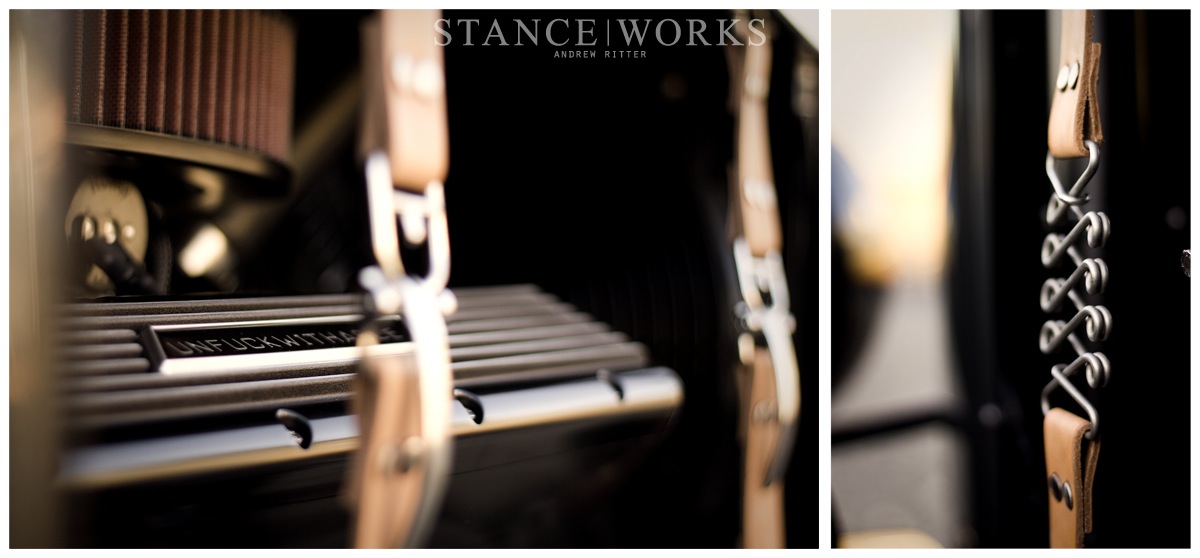

The details are not left-out with the drivetrain.  Nic had custom valve covers made up by C. Cook Enterprises, emblazoning the eGarage mantra boldly.   The chosen breathing apparatus was a Holley 670 Carburetor shooting air down through 2.5'' exhaust manifolds that lead to a full dual 2.5'' Flowmaster HP2's.   From the mufflers lead straight pipes out the center of the rear-end to expose custom tips that can only be described as the barrels of two machine guns. Details for days.

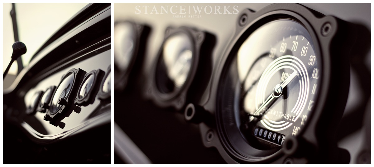

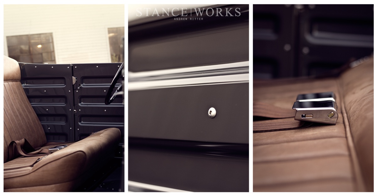

Not to be outdone was the choice of Hersey Milk Chocolate distressed Italian leather to contrast against the rich paint.  Even more so, the custom remnants of an aircraft interior that lay poignantly positioned throughout the cabin.  The centerpiece would most certainly have to be the custom gauges produced by Classic Instruments to, once again, be branded with the eGarage mindset.
Thus, you have the eGarage '27 Ford Roadster.  A car with stance and prowess that is only equalled by it's inward rage that commands your respect.  Builds like this should not be defined by an aspect or feature, but rather by the sum of all it's variables.  It's how the build equation is designed, so that all parts might work in union to showcase the vision in it's entirety.
